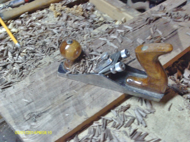

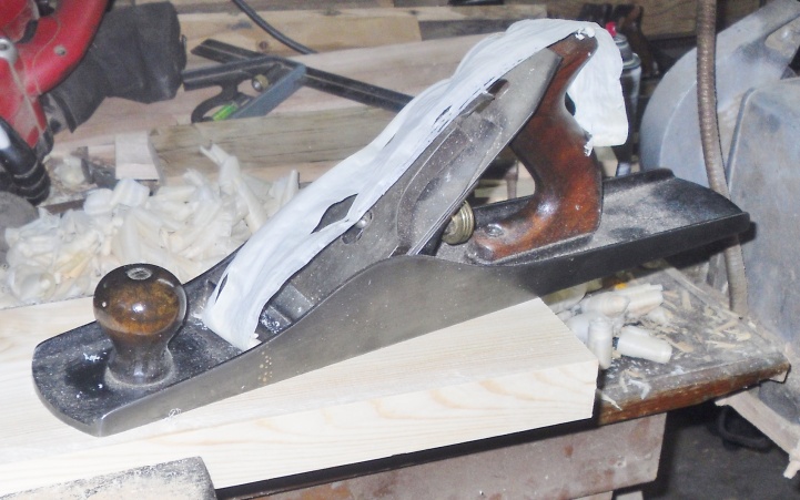

still, I do like a bevel down planening-sdc15354-3336-12.jpg?width=721DE6c Rebuild.   Oh, I take that back, I DO happen to have a bevel up planening-imag0008-3336-98.jpg?width=721Hungry little beasty, a Harbour Freight #33, reground as a #3 sized Scrub plane.  All $9.63 of it.   About the same type of plane as a Stanley #40.    Thick iron, 3" radius camber.   Have sharpened it once since the regrinding was done.

 Seen the video, over on SMC.     Also seen how this works on mine.     A few planes I"ve had will not close up to the edge, and still be able to adjust the depth ( ran out of threads on the wheel) so either a camber gets ground, over they are sold off.
