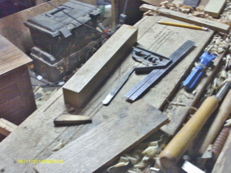

So, what do I do for the rest of the week.....ahning-imag0041-2530-79.jpg?width=750Get a few "parts" together.    Will have to find some square nuts for some 1/4" bolts.    Block and that slat are well seasoned White Oak.    Not sure about that wedge, might make a better one.   That piece of iron?    needs some work....   Stay tuned.....

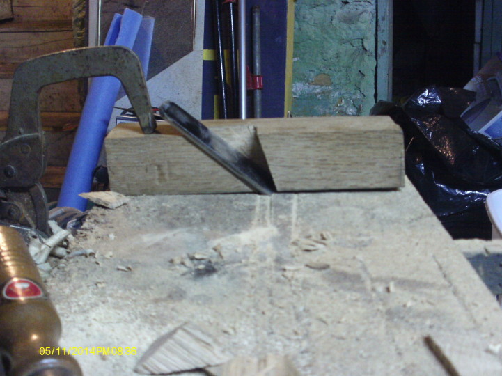

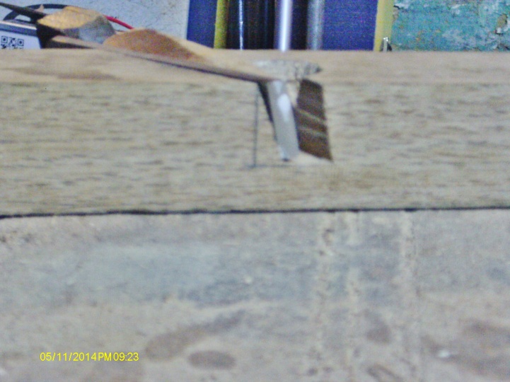

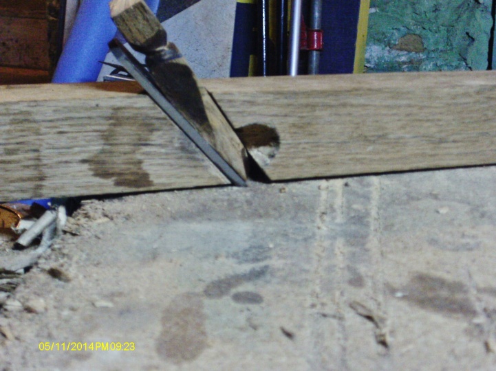

Whew!  two hours of sawing, chisel work, and grinding, and all I have done is this???ning-imag0045-2532-4.jpg?width=721First attemp didn't go as planned, thoughning-imag0044-2532-69.jpg?width=721Some dummy still can't use a saw.    Wedge area is too wide.    Used the second blank for the one above.    Different iron.  I used a H-F 1" wide skew chisel.    Reground the edge a lot, and then reground it again.    Iron sits at an angle, almost a skew plane.    The escapement hole was chiseled out with a 1/4" wide chisel.    Still have a bunch of stuff to do, yet.  A look at the bottomning-imag0046-2532-24.jpg?width=721Yeah, a skewed iron.    Still need to make a fence for the bottom.   Maybe shape the top a bit more for comfort.    Ten minutes  my   a.........
