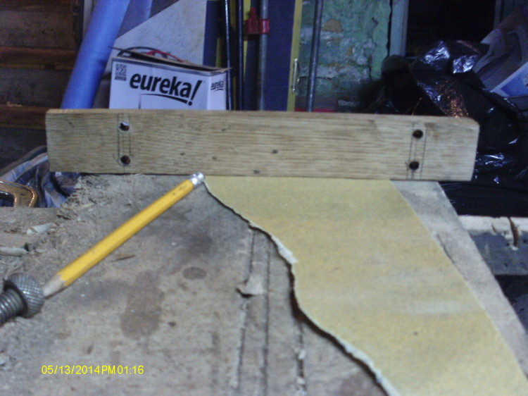

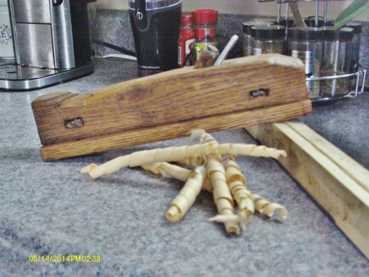

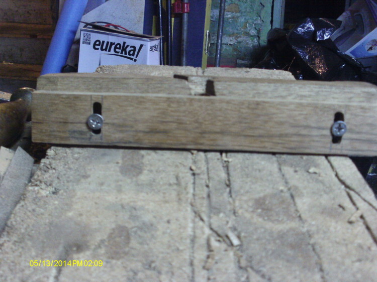

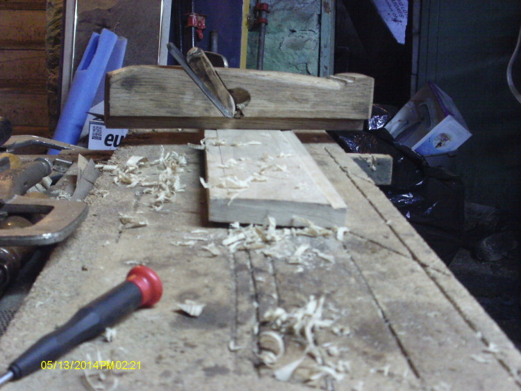

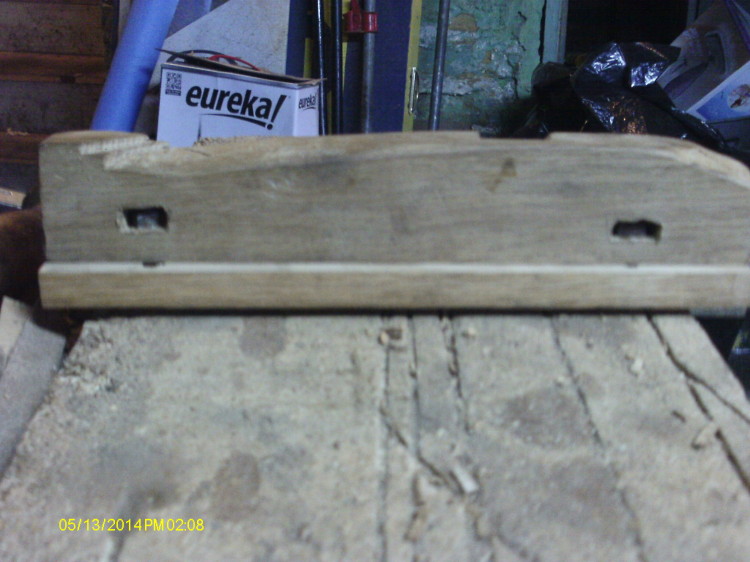

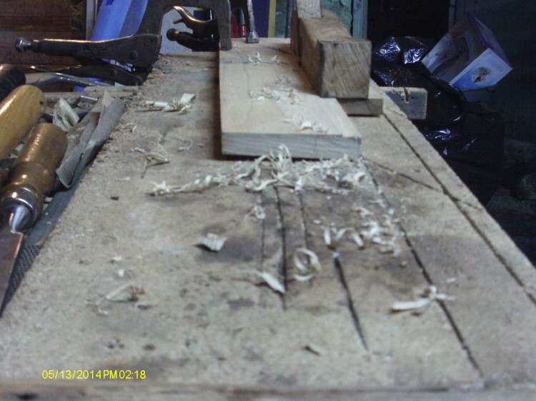

Been trying to get this thing finished upning-imag0051-2445-54.jpg?width=750But i still needed to add the guide fence TO the plane.  ning-imag0053-2445-44.jpg?width=750The "plan" was to make two slots, for the bolts to go.    First fence was about two chisel whacks from being done...SNAP.   Plan B then.   Re-do the fence from a second  piece of oak, using a 1/4' Forstner bit. ning-imag0055-2445-9.jpg?width=750Yep, like that.    Bolts are held in the body by two nutsning-imag0054-2445-52.jpg?width=750Not the neatest  "square holes'  but they do work.    Iron was sharpened up, fence set to about 3/8" wide cut.   Small hammer to set things.   Test track of Poplar clamped to the benchning-imag0057-2445-73.jpg?width=750This was after adjusting the depth.   Was just a tad deep.    Found out that this was against the grain of the Poplar, so, I turned the board aroundning-imag0058-2445-14.jpg?width=750and we have curlie things.    Still needs a bit more "fettling" and MAYBE a finish on that old oak.   6 hour build....

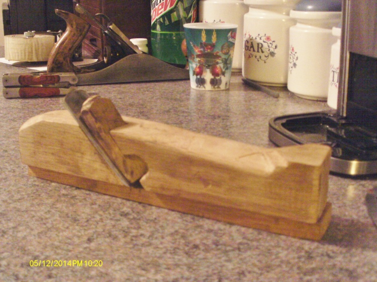

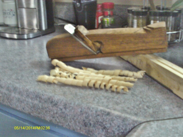

Seems to cut pretty darn good being pushed alongning-imag0055-2446-6.jpg?width=721Coat of oil finish.    Makes nice curlie-Qs!     Once i got the wedge fine tuned up, and set the iron just right.  ning-imag0051-2446-9.jpg?width=721Might just work....
