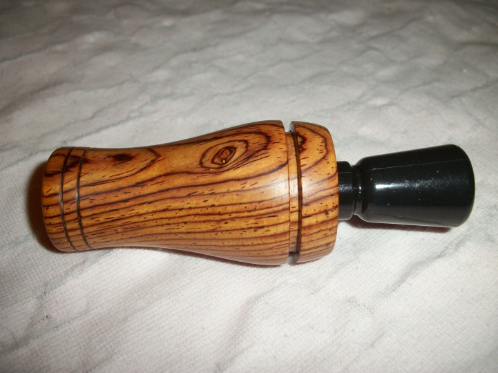

ning-duckcalls001-2402-37.jpg?width=721
Well, there it is. The first of hopefully many duck calls. I do have issues with it though. The instructions and many YouTubers say to drill a 5/8 hole in the blank for the air to go through, but that is actually (in my opinion) a bit too lose. It doesn't take any pressure at all really, to pull the call apart. Not a good thing I don't think. Sure you want access to the reed so you can make adjustments if you want to, but there I think should be some effort placed in pulling it apart. So I think what I will do is make another piece and drill a 9/16' hole instead of 5/8" I think that I will also make it somewhat smaller in diameter.
Live and learn I guess.
Any thoughts or suggestions would be welcome.
  • 2 weeks later...
That transition area just below the mouthpiece is always the thinnest part on any of my calls and I try to keep the walls there at a minimum around 3/16" thick, but I'm usually a little closer to 1/4". Sometimes a little thinner or thicker depending on what material I'm using and what kind of sound I'm after (both of which are also related).
Thanks. The mouthpiece wall in this case worked out to about 1/4" wide then necked down to about 3/16, then very quickly widens out again to finally end at about 1/2" wide at the back, which personally I think is too much, but that's ok, after I get done with the current project, I will remake it and see how that goes.
Thanks for your input :)
You'll eventually find your own style and things will only get better from there. One thing I will advise though is to try and incorporate a a style that includes a metal band of some sort at the insert end so you don't end up with any splitting on you... or worse, splitting on whomever you give or sell a call to. I've had a couple do that to me when I first started playing around with duck calls.
OK Thanks. This particular one, the Arkansas Magnum, didn't come with a band or lanyard so I had to basically wing it. I hate doing that lol.
I have no idea where you're doing your shopping now, but Check out Echo Calls online to see if you can work their call making stuffs into your projects.
OK Thanks I will.
