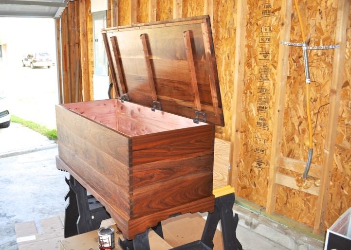

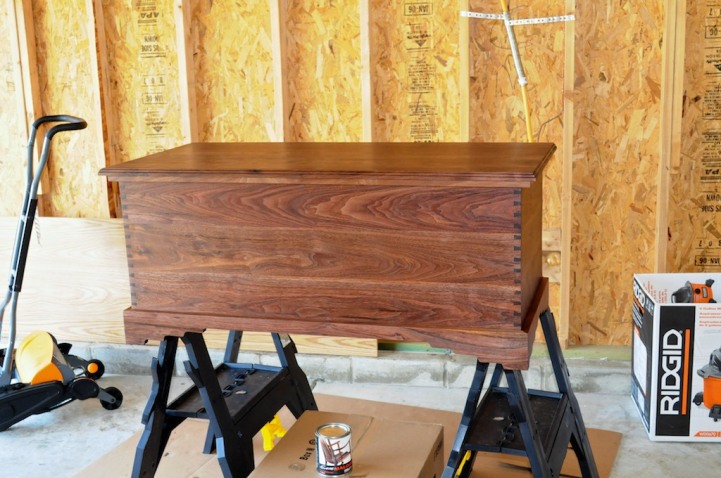

August 21, 201412 yr comment_2342 I like the wipe on oil finish as it is easy to do and gives beautiful results. It is a finish that does need to be maintained over the years but it is an easy thing to do. Below are a few pics of the Cedar Lined Walnut Blanket Chest that I made with John Moody and Ron Dudelston for my son and daughter in law this past month while we were back in Indiana and Alabama. Since I had to do the work in my son's garage of the house they just bought, I just went to the local Rockler Woodworking Store and bought a quart can of the the "Sam Maloof Finish" which is an equal 3 part oil/varnish/minieral spirit that is pre-packaged as opposed to buying the separate elements as it was less expensive and I did not have to deal with measuring or mixing but just had to stir the can. I put on multiple coats for a 4 day period before we had to head back home to California. The results were beautiful. This is the walnut chest with no finish after we wrapped it up down in Alabama at John Moody's shop. It still needed the trim and cedar lining and final sanding which Ron Dudelston and I did back in Ron's shop in Indiana. Here is the walnut chest after getting the multiple coats of the 3 part oil/varnish/mineral spirits mixture done in my son's garage. It turned out beautiful. Report
August 21, 201412 yr Author comment_2341 I love that grain Allen, it turned out absolutely gorgeous Report
