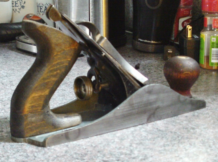

Has a look to it like a Victor/Handyman model.   Made for Wards as a Budget line of planes.  ning-imag0068-2336-5.jpg?width=750Still a ways to go.  Iron has a few "issues"  at the moment.  Rest of this thingning-imag0066-2336-53.jpg?width=750Sole does look a bit better.   LOTS of scratches to removening-imag0064-2336-36.jpg?width=750That fancy Kitchen light again.    Shines up yellow on anything shiny.    Knob bolt is brass, but the one holding the lever cap is steel.ning-imag0065-2336-71.jpg?width=750Brass PLATED wheel.   Just over 9" long, with a 2" wide iron.   The tote repair was by the seller.   It is solid, but not that good looking.   Cast iron frog, too.
Iron will need to be re-ground to square it up, and then sharpened up.  Again.  Out of square, and a Reverse Camber.    Higher at the corner than the middle.   We're getting there...

It really doen't take all that long to do.     I have just been wire brushing, and a bit of sanding lately.   Hardest part is the irons...
