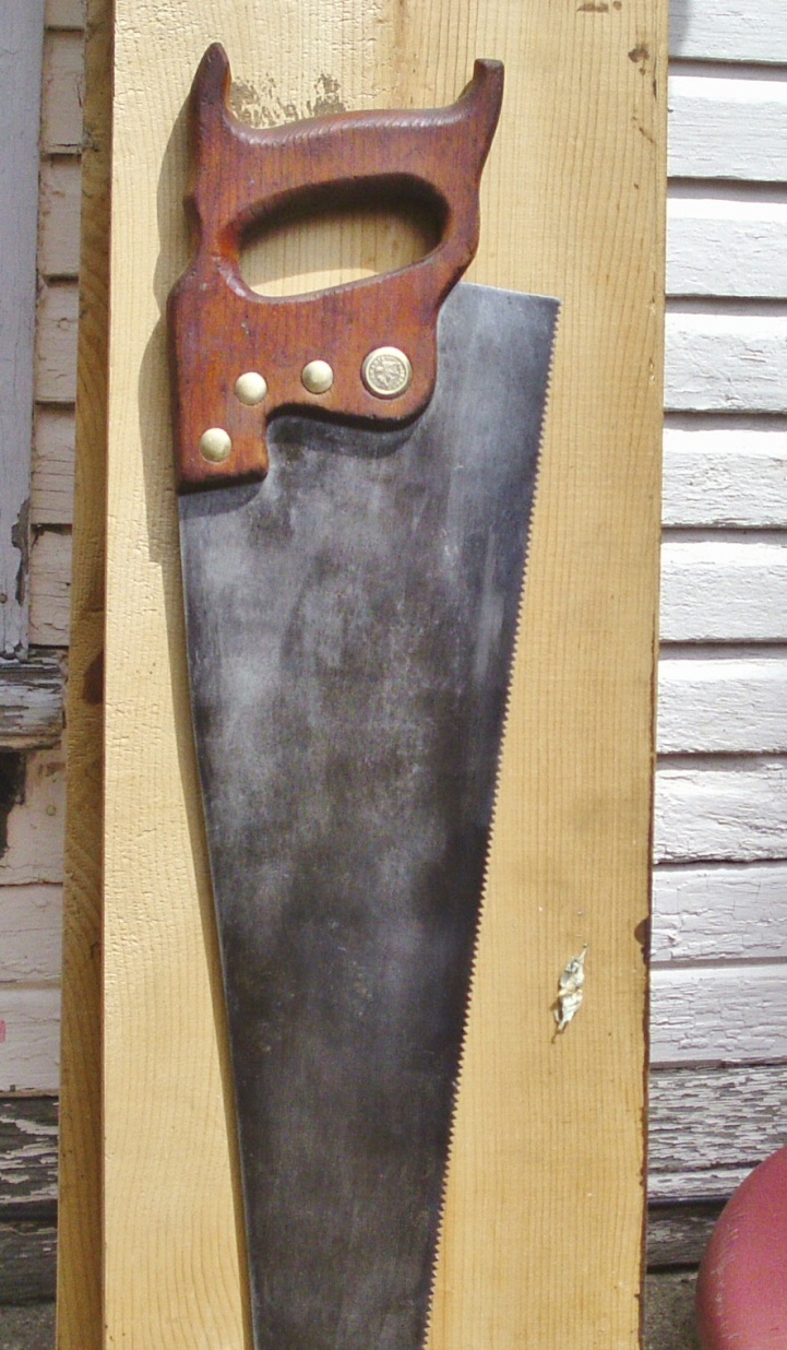

Ok, saws are now presentable to Polite  Companyning-imag0140-1151-10.jpg?width=721The tote and hardware came from a Diamond Edge parts saw, the 11ppi blade used to be that RUSTY sandvik.    Pit City!  Serves as a temp. home for the DE parts, so they don't run off and hide.ning-imag0141-1151-3.jpg?width=721Warranted Superior 8 ppi skew back saw, maybe a disston made.  This one had painted scenes on both sides. ning-imag0142-1151-51.jpg?width=721Unknown maker, weird bolts.   Had paint  on both sides and part of the tote.  Roundover bit to soften the edges a bit, was too blocky.  ning-imag0143-1151-95.jpg?width=721And the star of this show. Disston D-8 8ppi skew back saw. steel hardware, BIG medallion.   has a 95% readable etch.   Had a painted scene  on this side only.    Teeth are still sharp.  Parts saw?  Yep, got the Parts Saw completed as wellning-imag0145-1151-41.jpg?width=721Warranted Superior 8ppi crosscut.   Steel hardware.   Transplant a better handle onto a decent sawplate.   Etch?ning-imag0144-1151-36.jpg?width=721You can just make out some of it, where Henry Disston is bragging about his saws, and signed it.   Need to get some blue stuff and highlight the etch better.
