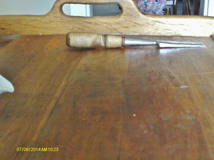

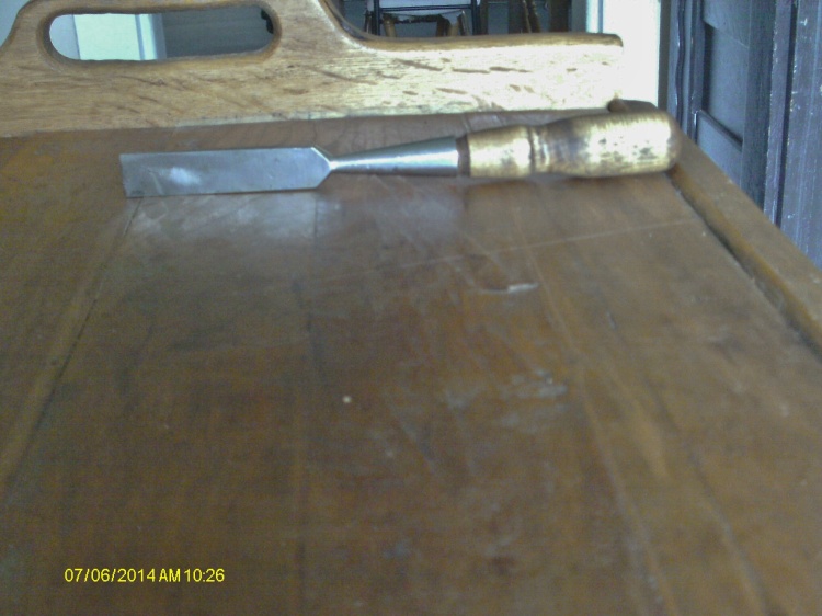

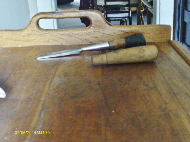

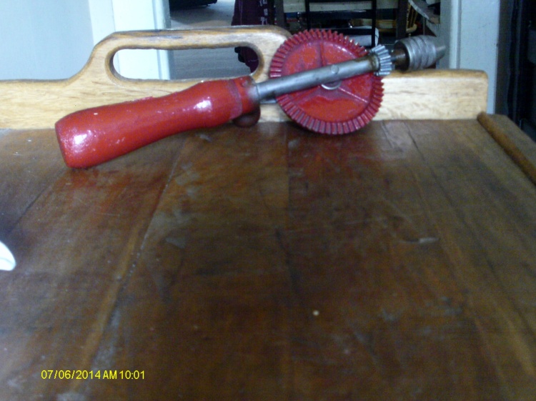

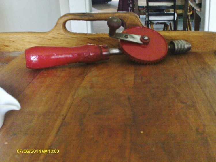

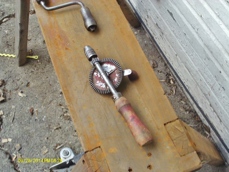

July 6, 201412 yr comment_1130 An eggbeater drill came in, all frozen up, and a little bedraggled.  Got it all torn apart, cleaned and oiled back upAh, yep. Everything works, but things look like they need just a little something addedah, maybe redo that red paint?From Rustoleum.   Not too badand, it still works!  Ok, also got in a Craftsman Stainless Steel 3/4' wide chisel. i did get the edge reground, and sharpened back up.   but, there was something else to be done.  The handle in front was an old file handle. Getting it mounted on my lathe took a few tries.   Finally got it to run almost true.  Tool rest was twice as long as the handle, and I couldn't get very close. Scraper chisel, a skew and a gouge, and a parting tool, for the shape.   Sanded smooth and coat of stain as a sealer.  Then wipe away the excessMight look a bit betterCheap way ro get a "new" chisel... Planer? I'm the 'planer', and these are what I use... Report
July 6, 201412 yr comment_1137 Love it Steve! Does that old drill take the square shank bits? John MorrisThe Patriot Woodworker Report
July 6, 201412 yr Author comment_1136 Takes small round shank bits.  Has a three jaw chuck.    Little hard to crank it tight, though, no chuck key...Planer? I'm the 'planer', and these are what I use... Report
July 6, 201412 yr comment_1135 Is there supposed to be a chuck key Steve?steven newman said: Takes small round shank bits.  Has a three jaw chuck.    Little hard to crank it tight, though, no chuck key... Planer? I'm the 'planer', and these are what I use... John MorrisThe Patriot Woodworker Report
July 6, 201412 yr Author comment_1134 Just hang onto the crank handle and twist the knurled part on the chuck. Planer? I'm the 'planer', and these are what I use... Report
July 6, 201412 yr comment_1133 That's what I thought. steven newman said: Just hang onto the crank handle and twist the knurled part on the chuck. Planer? I'm the 'planer', and these are what I use... John MorrisThe Patriot Woodworker Report
