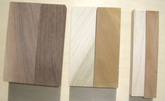

August 21, 201412 yr Author comment_370 I did a little experiment. The results were somewhat illuminating. Dipped a stick each of walnut, maple and poplar in a solution of 1/2 cup of water and two tablespoons of baking soda. That darkened the poplar somewhat, the maple not at all and the walnut quite a bit. Then, I made some tea. A one quart sized bag in 2 cups of boiling water. Let it steep for 1/2 hour. Washed a stick of each wood with the tea. Let it get pretty dry and then dipped it in the baking soda solution. The maple took on a really golden honey color, quite nice. The light part of poplar got pretty dark and the green part turned brown. The difference between the light and dark became quite muted. Still discernible but not nearly as stark as before. The walnut got a shade darker than the piece just dipped in the baking soda solution. With all but the poplar, I think the same effect could be had with stain. But, my experience with staining poplar leads me to think that a pre-treatment with the tea and baking soda would at least produce a more even color after staining. As to white oak, Phyllis and I experimented with fuming using ammonium hydroxide to darken our white oak A&C style kitchen cabinets. While the effect was very nice, we decided that the process didn't lend it'self to a whole kitchen of cabinets. We opted to dye them and were successful in achieving nearly the same effect. Report

August 22, 201412 yr Author comment_367 Left to right: Walnut, Poplar, Maple.Untreated on the left of each treated sample.Crappy camera. The poplar’s untreated piece didn’t show it’s contrast between the light and dark. But, there is quite a contrast. Report
