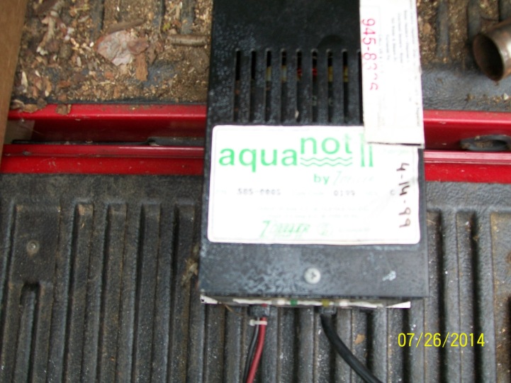

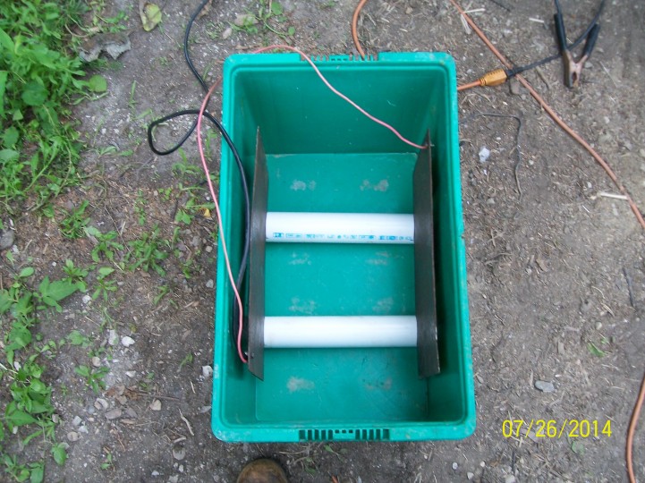

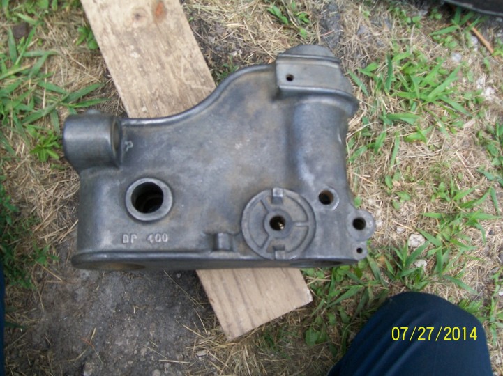

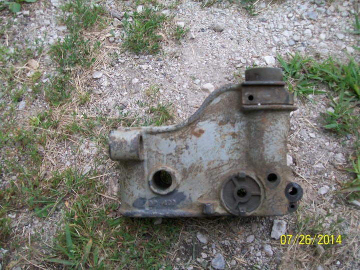

August 24, 201412 yr comment_281 Hi Will, I use the electrolysis method for cleaning up my "Old Delta Machines" It sure is a work saver. Here's a couple of before/after shots of a Drill Press head casting. This head took a bit longer than normal to clean as I suspect it came out of a metal working shop. It took about 20 hours in "The Tank" to get it that clean. I'm using a 25 Amp charger from one of those battery back up sump pumps, with a car battery in the circuit. The charger was a freebie from my neighbor, and makes a big difference compared to my old 6 Amp charger. That is my small parts cleaning tank. The same neighbor just gave me a big orange plastic laundry cart on wheels which will probably fit a complete Uni-Saw. Larry Old Woodworking Machinery Forum Host Report
