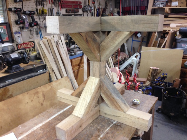

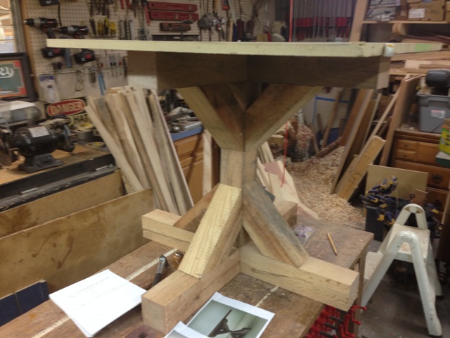

September 3, 201412 yr comment_174 I have been commissioned to built this Breakfast Room table for a customer that is working with a designer. They picked out this table but it only came with a round top and she wanted square. That is where I came in (not the square part) but the square top. Since they couldn't purchase just the base and make the top I got the job. So they wanted this made from reclaimed material. As it turned out I have several old church pews and they lady I am working with is a preacher's daughter so she loved the idea of the top being made from the old oak pews. The other lumber is some I got from an old building that had been torn down and they salvaged as much as possible. So this is the table they found and liked. Monday, I was able to get a few pieces cut and had a meeting with the customer to see if she really wanted reclaimed and how much of the old roughness did she want removed from the lumber. This is just tacked together to give her an idea of what is would look like, nothing is attached yet. She wanted to see what the top would look like and all I had standing around was a small piece of MDF so I put it up to simulate the the top. So the project is underway and I have a lot to do yet, but we will get there. I'll post updates as we work through this table. I have several other projects we will be doing in this house. Stay tuned for updates. John Moody Site Administratorhttp://www.johnmoodywoodworks.com “Don’t make something unless it is both necessary and useful; but if it is both necessary and useful, don’t hesitate to make it beautiful.†Shaker Saying Report
