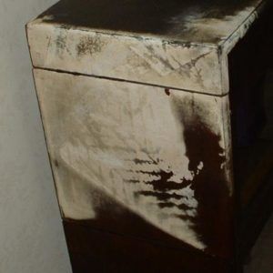

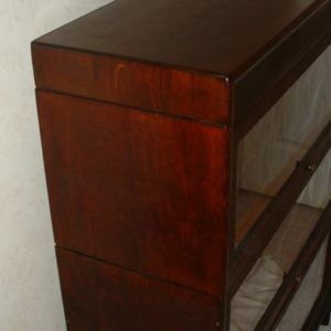

  • My go-to was to use a wiping cloth made especially for removing the spots. It always worked. But it left a spot that was bit oily and maybe a bit glossier. No problem to clean up and it with some touch-up spray. (see attachment)
  • Proprietary products, normally a slow or weak solvent. Might be called a "restorer", "blush eliminator", "ring remover," or "reflow solution." Applied and left to dry. I had a regular customer who was in a site with a too-small warehouse. So often the pieces needing work were in a semi trailer backed up to a dock. I'd spray on some touch up spray and it would blush during the humid summer weather. So then I'd have to spray on some blush remover and let it dry for several minutes. Then repeat multiple times.
  • In a severe case, a moving blanket was on a leaking moving van and blushed an antique piece. The owner, who must watch Antiques Road Show, did not want it stripped and refinished. I used the cloths above, working but slow. Since I figured on the age it was probably shellac, I put some denatured alcohol on a cloth and did a quick land-and-take-off wipe. The blush disappeared immediately
