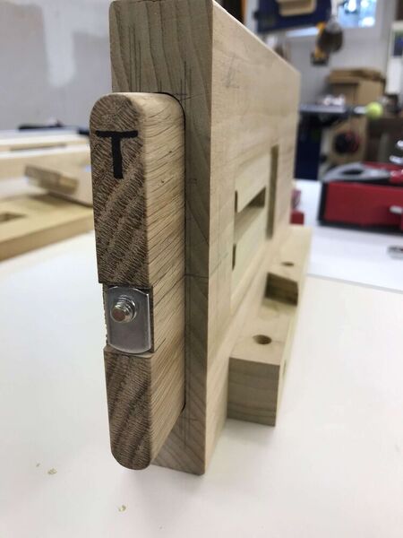

you could also add double mortise with floating tenons (can be handy when the tenon piece is not long enough to make a integral tenon).

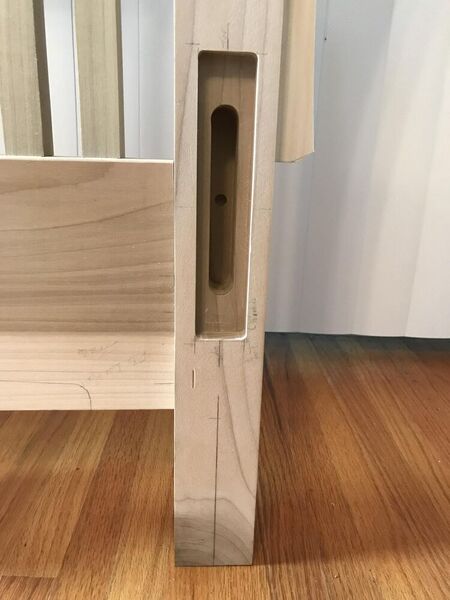

You may want to present a housed mortise and tenon joint. Danl
What exactly do you mean by that?
The beam (1st tenon) and tenon (2nd tenon) are housed inside the two mortises. Danl
