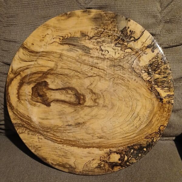

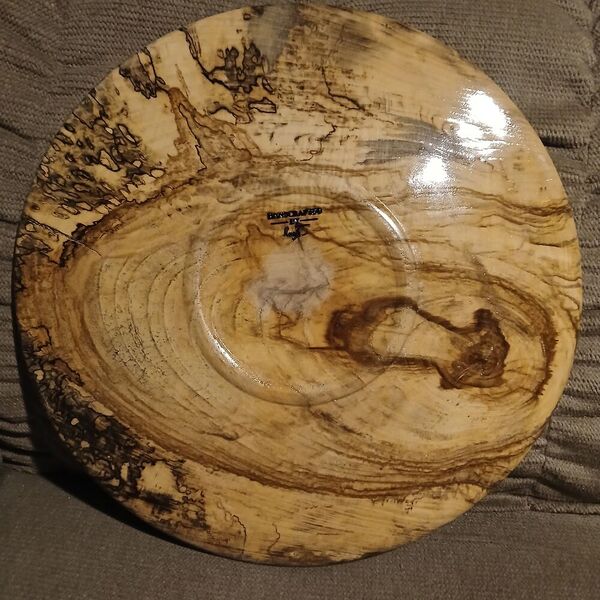

Turned this platter a short time ago and except for the usual problems associated with half rotten wood all went well, until I started spraying a finish. Finish is shellac from a rattle can. I've used it countless times before with no problems but this tia spot centered on the bottom keeps soaking up finish like no tomorrow. As of now I have put more coats of finish in that spot than I can remember sanded back refinished and refinished again. Now I have pretty much decided that it is what it is and set it aside. So if someone has a solution I'm all ears 20260922_185431.jpgFront 20260922_185445.jpgProblem spot.

How about just a dot of CA near a darker (Red circle) area and the see if shellac soaks in?
At first I was thinking punky but now believe there was something that soaked into the wood in that area. Have you tried sanding the area out? Another way is to decorate that area with Sorby Spiral or Wagner tool .
Well go back to thinking punky and add end grain this piece had about every horror you could imagine. no it's not turned completely end grain it changes, i didn't think it was possible but here it is. Love your idea of texture or spiral decoration but I don't own any of those tools so still looking for plan B. Still thinking about Lew's suggestion on using CA. MaybeArguingSmileys if I can stop arguing with myself.
