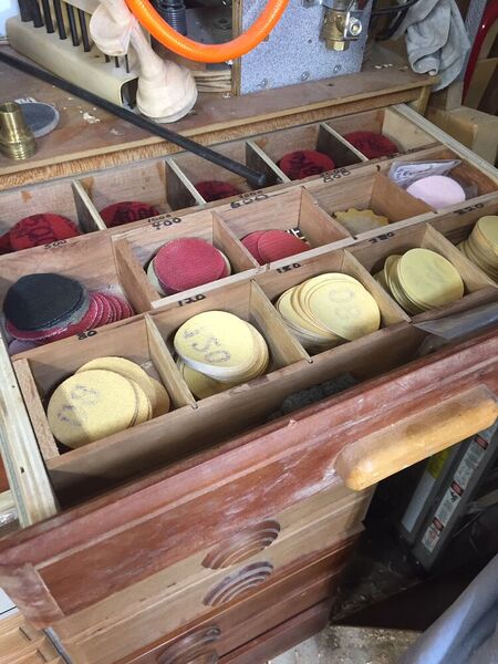

He has Mirka Gold and for me it works best. Have tried Blue Ice and Abranet and some others but just makes for too many types. It is best to stick with one type as grit sizes vary from one brand to another.

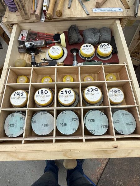

This is my storage drawer for supplies.
