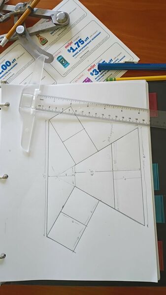

Let's suppose that you want to build a platform up about 7'. It will be about 14' wide on the back end and 10' the front end, 4' front to back. It will only be supported on the 14' side and on the ends (tapered in at 60 degrees). The 10' side will be an open span, This is for a theater set. and there will be three adults on the top.
The set manager wants to do one 2x10 across the open front (10') and another across the back. Then run 2x6s across from the front to the back 2x10s. Will that be strong enough, or would it be better to run 3 or 4 2x10s the long way? The back joist will be supported by a wall (I think)
