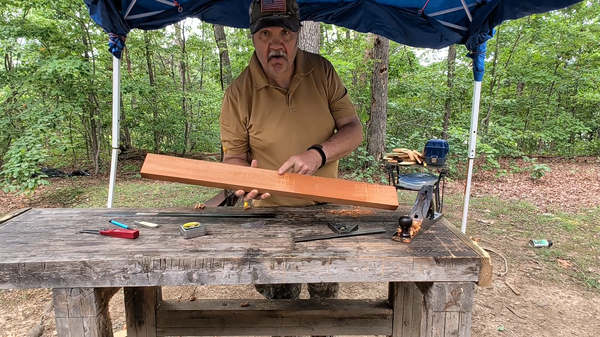

As usual, the blank is not flat to start out with.
As a side note you will notice there is no apron in site. Virginia summers prohibit this article of clothing, lol.
So we need to make said blank flat and square, and remove any twist.

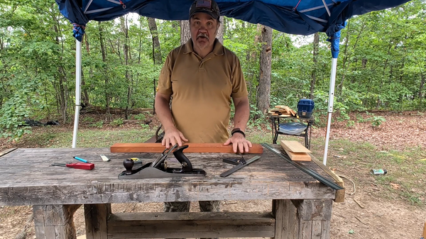

So I place the blank in my vise and employ the Jack.
and after a few passes we see how far out the blank is. You can see where the plane has cut and where it has not.

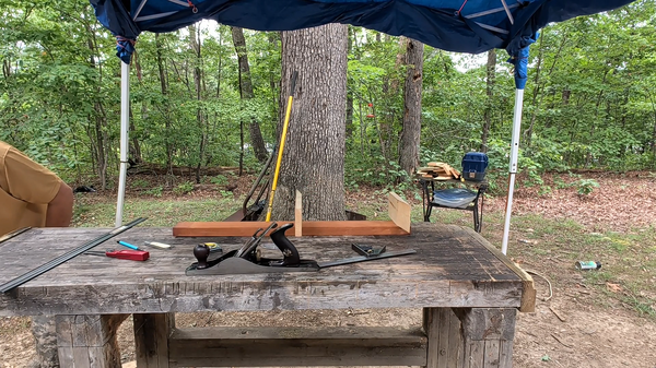

Then we check an edge for square
And find out it isn't. Back in the vise it goes.

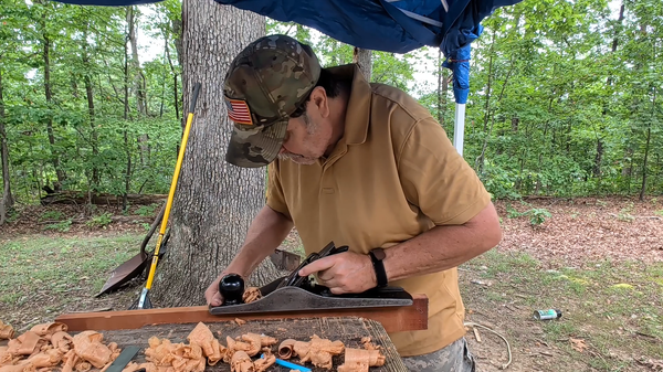

and good old No. 6 makes her right.
Edited by Handfoolery
The opposite face and edge are trued up in the same manner, using the first face and first edge as Reference points for square.
