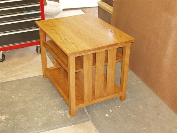

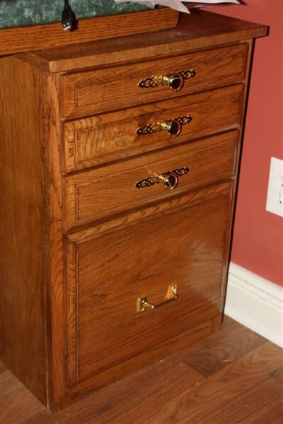

Here are a couple pieces I have used white oak for.
