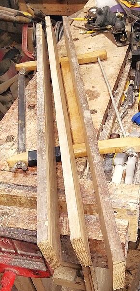

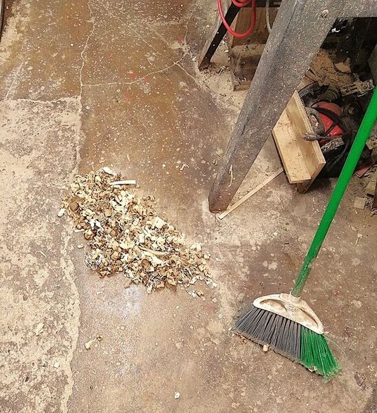

June 14Jun 14 Popular Post comment_377683 There was 4 planks in the old bench..One had disappeared, still had 3 ( may have burned that 4th one?)Handsome, ain't they? Ends needed to be...gone..Seems they just might be oak?Then, run these through the Lunch Box Planer a few times, along with a few other cut-offs laying around..Pine was used to get the planer set for depth..took a few passes..The "After" One plank, I could only do one face, as the other face...Shiny spot is a nail of some sort, doesn't go the entire way through...first pass, and that showed up.... Shavings were supposed to wind up in this Trash Can..Kind of missed, didn't it?Still need to work on the edges..Otherwise, it might be a bit rough to get a panel out of this...Might need ti rip the sap wood off, too? Boards are now all at 5/8" thickness...will see what I can cobble up...Stay tuned.. Report

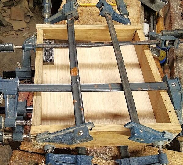

June 23Jun 23 Author comment_377990 Corners #3 and #2 were done did..Worked on Corner #4 this morning...cut a plywood floor panel to fit...and glued things together..Film in a Little bit..Stay tuned... Report

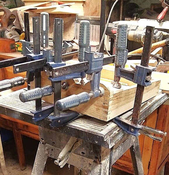

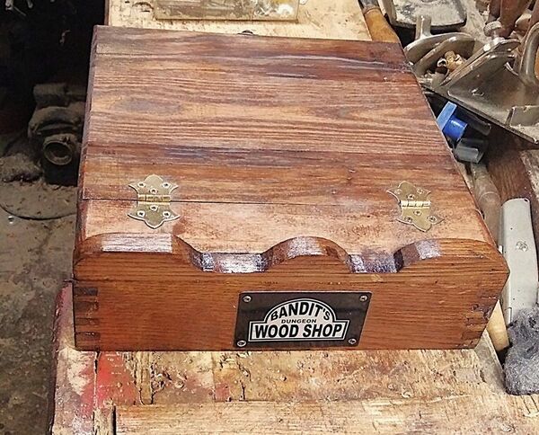

June 24Jun 24 Author comment_378000 #4 corner tried to be "Difficult", but...finally, after a dry fit to get the size of the 1/4" plywood panel, cut that, then plane and edge or 2 to get to final fitted size...clamps and Glue..Checking for square..All 4 corners,,,Side to the left is the Front of the box...when the clamps do come back off...I need to plane the edge to match the sides, might take more that a few swipes?I can also start to fit the hinge piece..Intend to rebate the underside a bit..and maybe round-over the top edges...the..Square this panel up, rebate the underside, incise the hinges, and add a Pencil/Pen Stop near the bottom edge. Might even see about a pencil/pen Holder for inside the box?Fun part? Will be the angle the lid meets the hinge board....Stay tuned Report

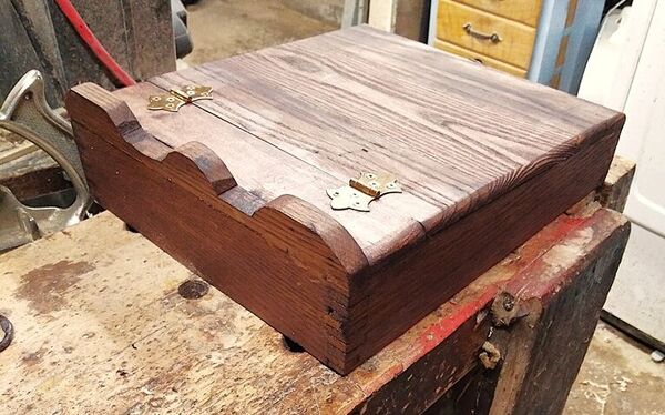

June 24Jun 24 Author comment_378035 Clamps came off, this morning. Glue joints were cleaned up...Bottom was leveledTakes a longer plane, to bridge around a corner..Hand plane to match bevels...Smaller plane was used to flatten a lid....once I got the panel squared up..Lid and the part it will attach to...meeting angles needed planed. Both needed rebates milled..Added a "Back stop"...which another meeting bevel was needed to sit up close to the back stop..Gives me a Finger-lift Edge...Back stop got fancy...Glue and clamps came back out..Back stop got glued in place, along with..The part the lid swings on...edges were rounded over...will do the same to the lid..Hinges?Whether to surface mount these, or...incise them down flush with the surface...hmmStay tuned... Report
June 25Jun 25 Author Popular Post comment_378085 Decided I had just better surface mount these..Because, I can't use this..Left-handed. Something about the Right thumb? Would have to bury the hinge barrels as well...PIP..Went around, filling in gaposis..square pegs into square holes...and trying to round over an edge or 3..Started with a plane, then sanded things smooth...Added a Latch...open the lid?Underside of the lid details..Just the perfect size for normal sheets of paper..Will try to brush on a coat of stain, later...we'll see...Ser Uncle Charles decided to attack me left foot's toes...Stay tuned.. Report

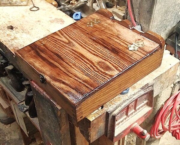

June 26Jun 26 Author Popular Post comment_378128 Stained, this morning..Inside and..Outside...Corner details..And a look at the back..Stain is Minwax "Red Mahogany"...brushed on, then wiped down...might try a coat of varnish, tomorrow? Stay tuned, almost done.. Report
