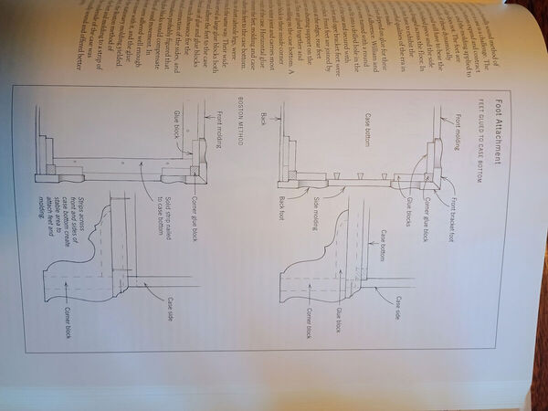

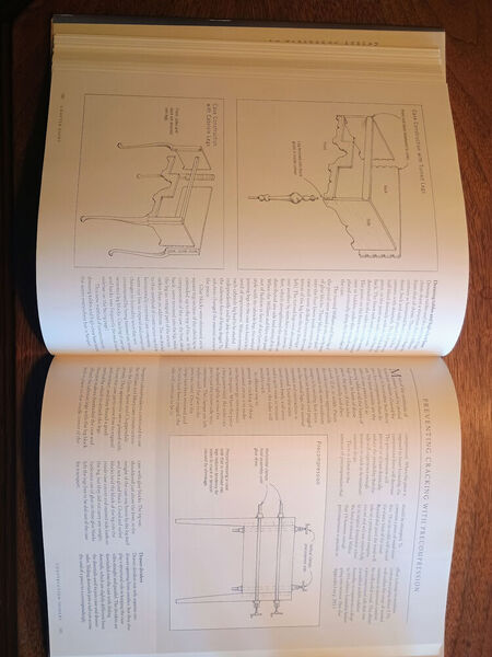

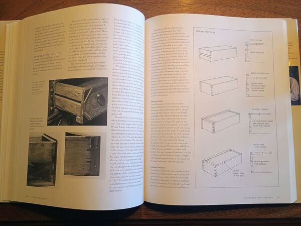

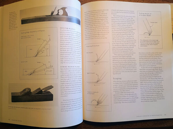

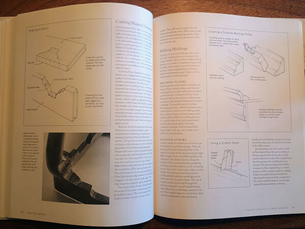

I finally got around to revisiting it, I think it is exactly what you want. He does tend to focus on handtools, something I forgot because you really can do traditional builds with a hybrid set up (what I do when I find time to build any more). He also covers styles and evolution more than I remembered, as well as a lot on carving and ornamentation. It really is a great "how to" book for traditional furniture and hand tool construction.
I snapped some pics for you. Sorry about the rotation of the last two, I tried fixing that but the algorithms seem to think they know what's best.

Wow. Thanks I basically just want a lot of construction photos and things like that so that I kind of get an idea about how things go together particularly things I might not have done before. I need to get like a solid grasp of historical construction. I've been flying by the seat of my pants on what I know and what I could learn on YouTube. I need to go a little bit deeper and that book looks perfect to me.
Thanks for the photos.
