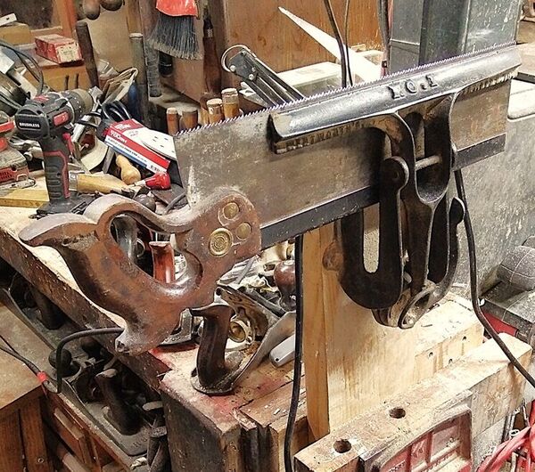

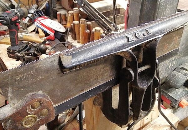

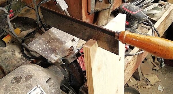

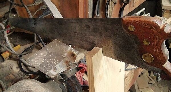

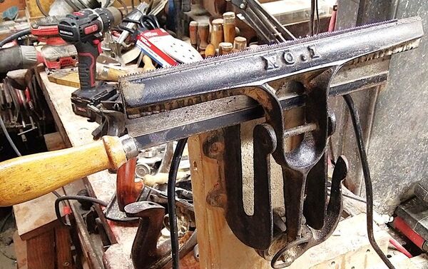

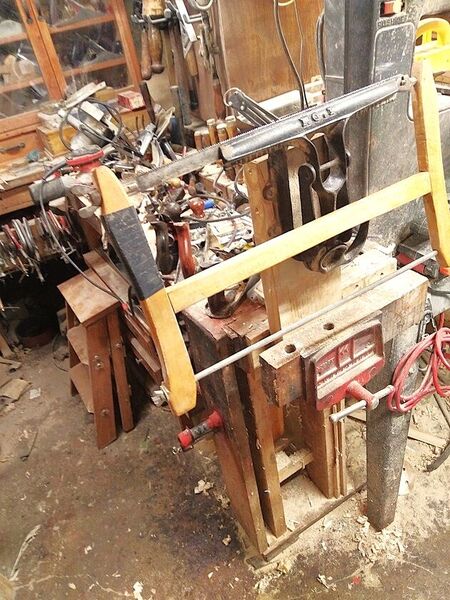

May 10May 10 Popular Post And trying NOT to raise any saw dust..Cleaned up old Wentworth No. 1Made sure there was clearance to allow the locking handle to open all the way...1st customer?Diamond Edge No. 0140....meant I needed to install a handle onto a XX Slim 6" file...and about 10 minutes after that..All sharpened. Test drive? Was done after the other 2 saws were done, but..Once it got started, I made about 10 strokes...seems to cut just fine..NEXT!Disston No. 4, 14" Backsaw...took almost as much time as the first saw did..Filed this one Rip...as that is what I use it for when sawing dovetails...Same with the Stanley No. 68 Gent's saw...just a LOT more teeth...test drove both..Kerf to the left is from the No. 4 Backsaw...both were given a 10 stroke test....Pine plank was not clamped to anything..other than my foot down at the bottom.. and my finger & thumb beside the saw...I think that will do, for now..

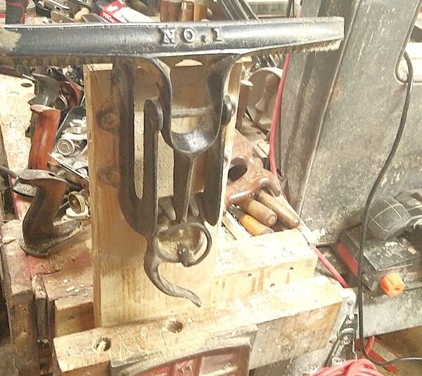

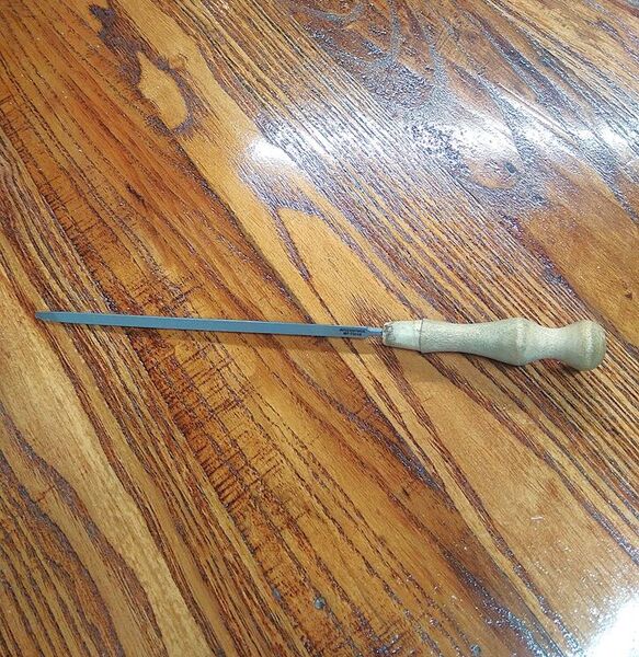

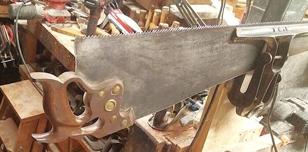

May 12May 12 Author This morning's Customer..100 year old D8 Rip saw..28" long...5-1/2 ppi. The "Work Area"?And the file used for all 4 saws..6" XX Slim Taper...had to install a handle on it, to get it to work...

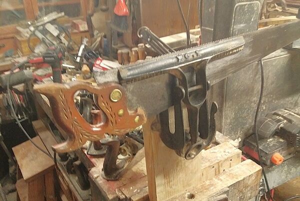

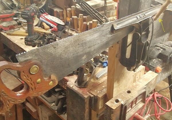

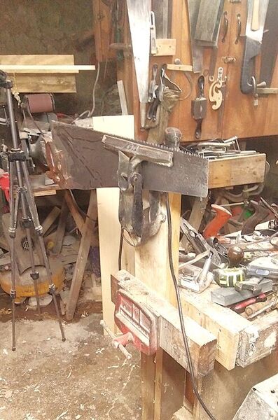

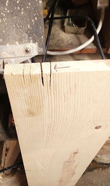

May 12May 12 Author Last night..Customer #5 arrived for a sharpening..Then the kerf from the Test Drive...10 strokes..Saw wanted to lean a bit to the right..Saw Vise has been stowed away on a shelf, for now...have other chores to do...
