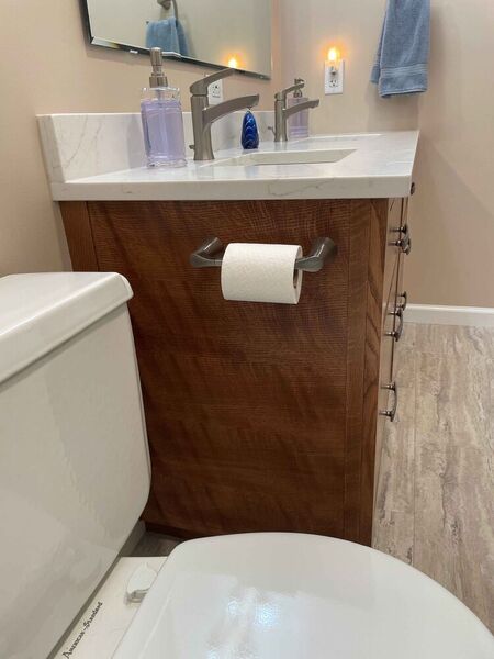

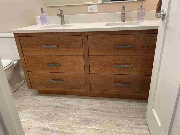

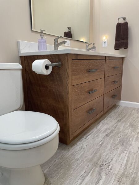

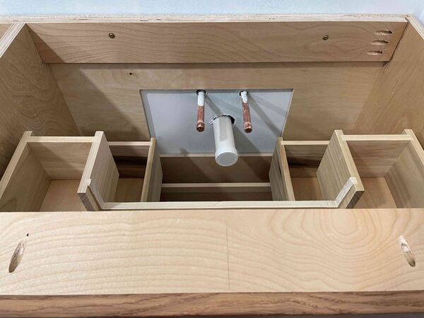

April 12Apr 12 Popular Post comment_374536 The hallway bathroom remodeling is complete. If you want to see the vanity build pics, look here. I had to communicate with the plumber and the quartz countertop fabricator to allow the drawers to be functional. The drawers were made months before the remodeling started. Thanks for looking. DanlWood: QSWO. The side of the vanity is shop made veneer. Finish: Transtint Med brown, shellac, & (3) coats SW Sher-Wood Kem Aqua plus clear, dull rub. Report
April 14Apr 14 comment_374624 Top level craftsman on the vanity Dan. Very creative solutions for your drawers to accommodate the plumbing. Nice finish shade; it really complements the floor tile. Report
