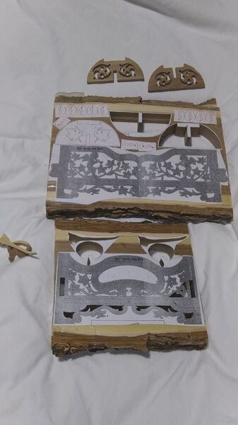

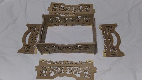

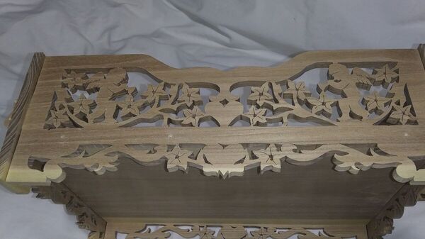

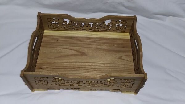

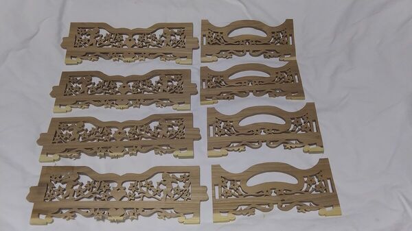

April 6Apr 6 Popular Post comment_374157 I made a couple of these, one to sell and one for my granddaughter. I stack cut these four deep. 1/4" Elm throughout. FD #1 blades for all the pierced cuts. BLO followed by shellac for the finish. I don't remember the name of the designer, if I run across it I will update. One of the things I had to deal with was the lumber for the sides was slightly bowed. So, when I assembled the parts I clamped the bow out of the sided and then pinned the tenons, when the clamps were released the tension locked the pins in place, that sucker isn't coming apart unless the sides are clamped again. :) Another issue was the drill bit used for the pilot holes bending inside the hole. one of the centers for the flowers show a hole at the outside edge and this was using premium cobalt alloy bits, I've watched the bits start to bend on contact with the paper pattern. I would love to try some solid carbide bits, but $$$. The bottom is also pinned in place, no glue or fasteners (other than the pins) hold this one together. : Report
