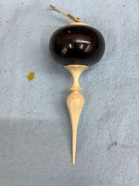

Disaster strikes
I was putting spray lacquer on five and dropped this one while turning it around.
Turn a new end, drill a hole for the shaft and glue it on or glue a bead on the end. It's too nice to lose it.
Yes going to try to save it one way or another.
I HATE it when that happens.
Bummer Rusty. No doubt with your creative skills you'll figure out a save.
Ok I very carefully cut the finial off. Very little sanding. Redrilled the 3/8” hole. Made a new finial and glued it on.
Great save Rusty. Nobody knows but us.😉
Good job. I had a passerby drop a lid with similar finial and broken tip. I was able to flatten tip , drill and glue back on.
Wonderful repairPraise . Now would you mind sharing how you held your ornament to work on it, Grandson sat on one and returned it for repairWonderScratch
I held the globe in my left hand and the finial in my right hand and ran it through my band saw very slow. I tried cutting very close to the globe for minimal sanding. I got lucky and cut it close enough for no sanding. I sanded a little anyway. Then I drilled a new hole and glued the new one on.
Leave it to me to over think things. simple is GOOD and your way sounds excellent, Thanks
