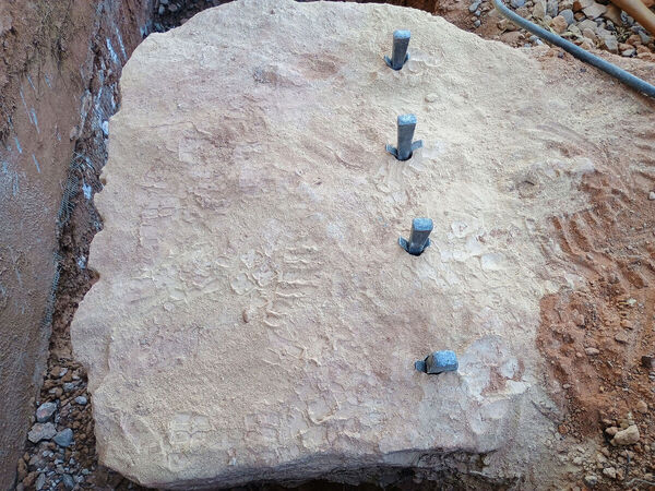

First drill some holes. These are 5/8" because that is the size bit I have for the little drill (40 year old Milwaukee hammer drill). I have more wedges for 3/4" but that is a real struggle in the Milwaukee and the Bosch demo hammer is waiting on O-rings to get it hammering again.

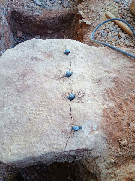

Next is to set up the wedges and feathers and get them seated in the holes. Once they are tight I just give each a tap or two and move on to the next one so as to get a crack started.

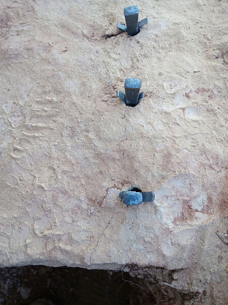

You can just see the crack starting
Bigger, but not fully loose yet. You can here the change in sound as the crack completes, tapping on a wedge goes from a sharp ping to a dull one with a hollow ring echoing out of the crack.
