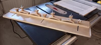

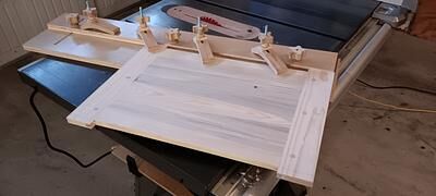

March 8Mar 8 Here's a Tapering jig I designed and built for doing tapered table legs on my table saw. I made eveything out of BB plywood. The clamps are made out of Douglas Fir. Knobs out of Pine. I used 1/4-20 hardware. BUT!!..... it also can be used as a jointer and squaring up work pieces. There is much it can do!It's beautiful to joint boards. It's been squared to my rip fence. It's pushed against the fence. You just move the fence where you need to and give it a run. Thanks for looking!Cheers!!MrRick
