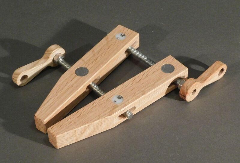

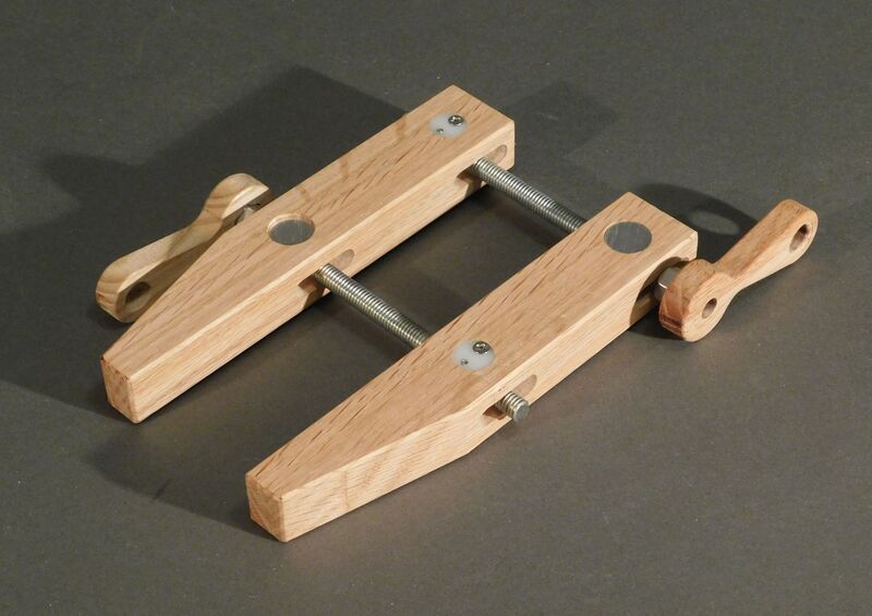

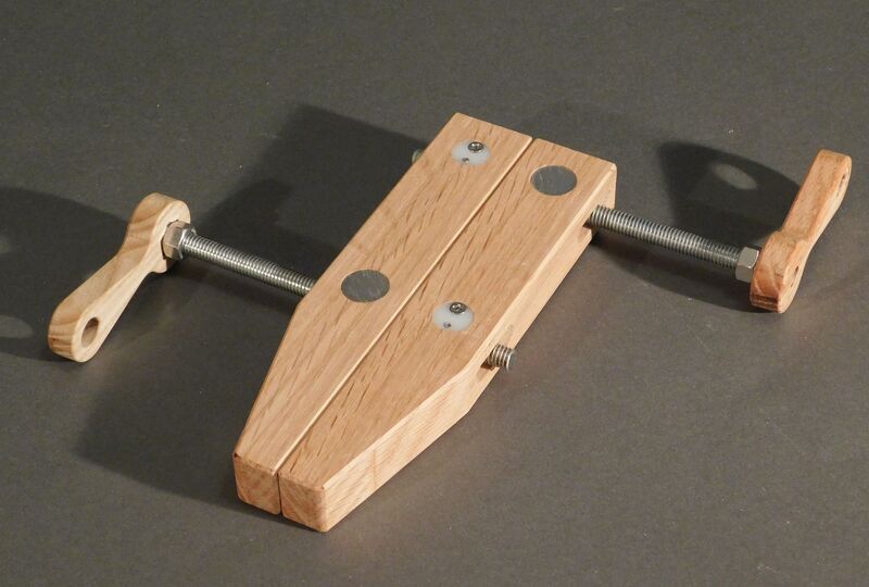

February 4Feb 4 Popular Post Made with two sections of standard 3/8-16 all thread, I used my push button design, some HDPE, a few #6-32 flat head screws, and some scraps of red oak. All the photos were take without spinning the handles. Push buttons quick to adjust, Once set to the width you want just release the buttons and then a turn or two of the handles to clamp down tight.You can see one button depressed in the photo above. Sometimes it takes a half turn of the handle to get them to pop up.Likely by tomorrow I'll have a detailed story about this clamp on my blog.4D Edited February 4Feb 4 by 4DThinker
