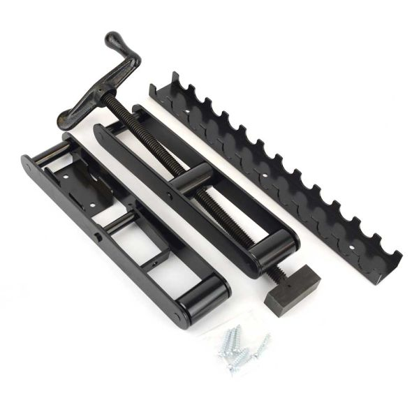

January 4Jan 4 Author Popular Post comment_368273 I stated in the first post; I'm using four way panel clamps, they look like this These clamps apply pressure to all four sides of a panel. While they are specific to panel glue ups, they are very flexible in that regard. Panel thickness 1/2" to 3 1/2" thickness (1/4" or thinner with a spacer and an extra 1/2" or 3/4" on the sides) and panels as wide as you can make cauls for. The 1/4" panels I can get out of my stock of Elm, but I'll probably rip them down and then glue up the panels. For the granddaughter, I want to make an heirloom quality item, so solid wood throughout and much attention to detail Report
January 5Jan 5 comment_368337 Hey, that's a cool clamp! Let us know how it works for you! I typically use about 5 normal pipe clamps on a panel that size, alternating sides (3 on one side 2 on the other). With those clamps pictured I think the 3 you have should be enough - but as I've no experience with that kind of clamp I'm not sure. For oversizing, I usually do about 1/4" per side on panels, so +1/2" each direction in total - but I have also been doing this since before I could drive so I have some level of confidence in how stuff will work out. You won't go wrong with +1", and the waste is minor compared to getting a good result so focus on the result. I usually cut panel pieces at whatever I can to get them to fit the final size and don't worry so much about making them even. The main thing is straight and flat for a easy glue up. Report

January 5Jan 5 comment_368369 I have a pair of those clamps and have a question(s): on a thin glue up, the flat rectangular piece that put pressure on the long side of the wood, how do you align it with the wood if the wood is less than 3/4 thick? If you put spacers under the panel how would you keep the panels flat to each other? thks Report
January 6Jan 6 Author comment_368380 11 hours ago, smitty10101 said: I have a pair of those clamps and have a question(s): on a thin glue up, the flat rectangular piece that put pressure on the long side of the wood, how do you align it with the wood if the wood is less than 3/4 thick? If you put spacers under the panel how would you keep the panels flat to each other? thks My plan for thin glue ups is to cut 1 x 4 to the length of the panel and then use a dado blade in the table saw to create a "tongue" on one edge that is the same thickness as the panel and about half the width of the 1 x 4 ( 3 1/2 / 2 = 1 3/4" ) . I would use these on each side of the panel so the clamp can press on the panel, even though it is thinner than the clamp face. 🙂 Report
