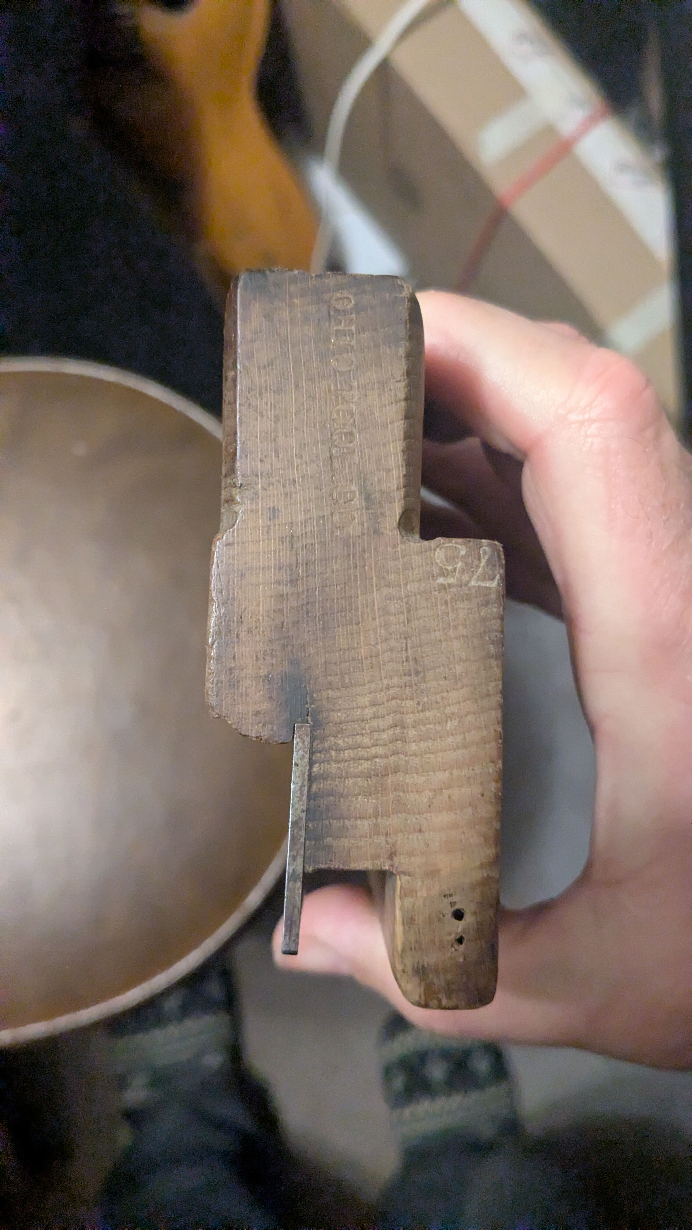

I recently acquired this
plane. It is a 5/16 grooving plane. It has been in the fle market I bought it from for at least six or eight months.

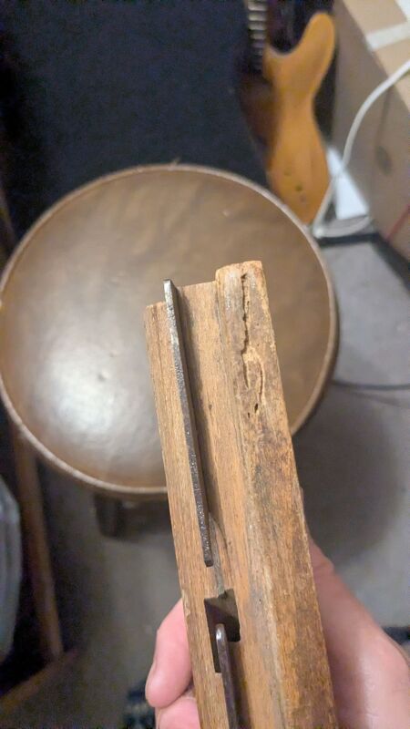

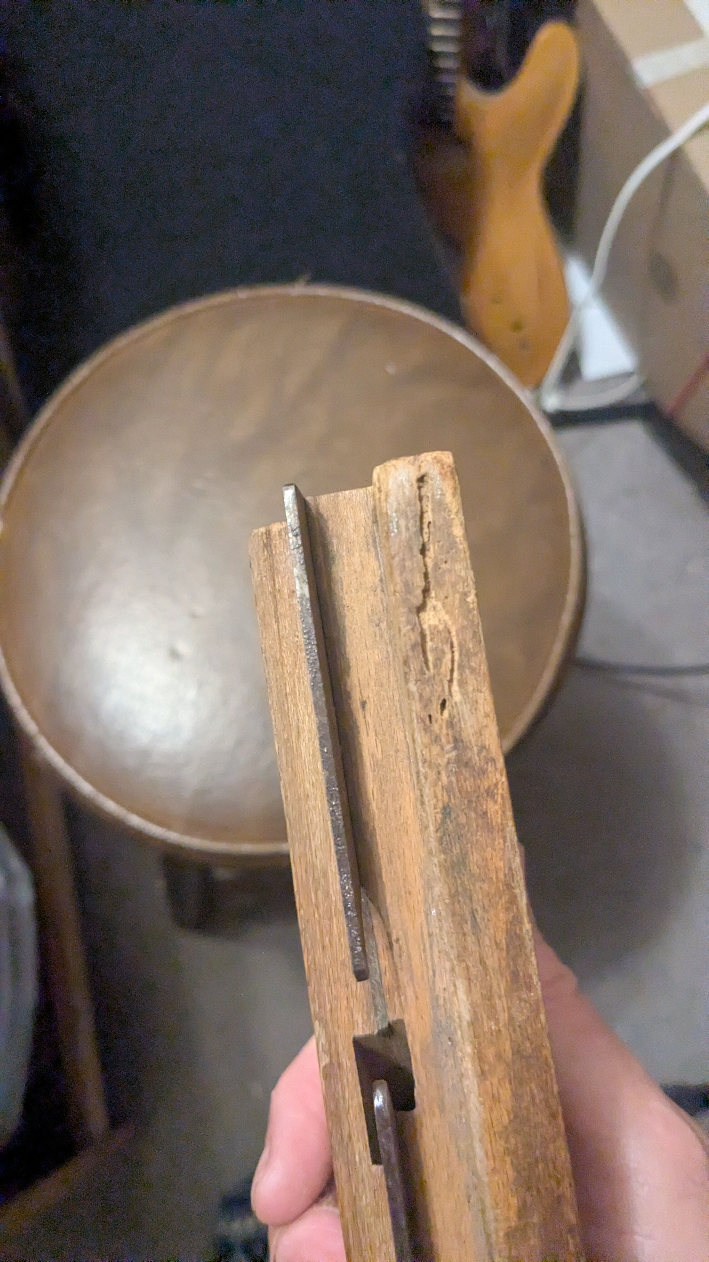

After I brought it home I noticed this.
Some kind of critter. I know it is possible that was made a long time ago, and that is the only spot on this plane.
Does anyone think I have cause to worry?
Thanks.
You don't have anything to worry about. As a precaution use a Q-tip and dab some ammonia over it and the holes on the end. Let it sit for a few minutes. Wipe off. Then dab some mild soapy water over it and wipe dry. Then you're good to go.
Nice score on the plane Mike. I agree with Rick. I don't think you have any reason to be concerned. Those bugs left the building a long time ago. If it was recent there would be some powder residue. I often use hydrogen peroxide and a soft bristle toothbrush to clean up old wood tools.
