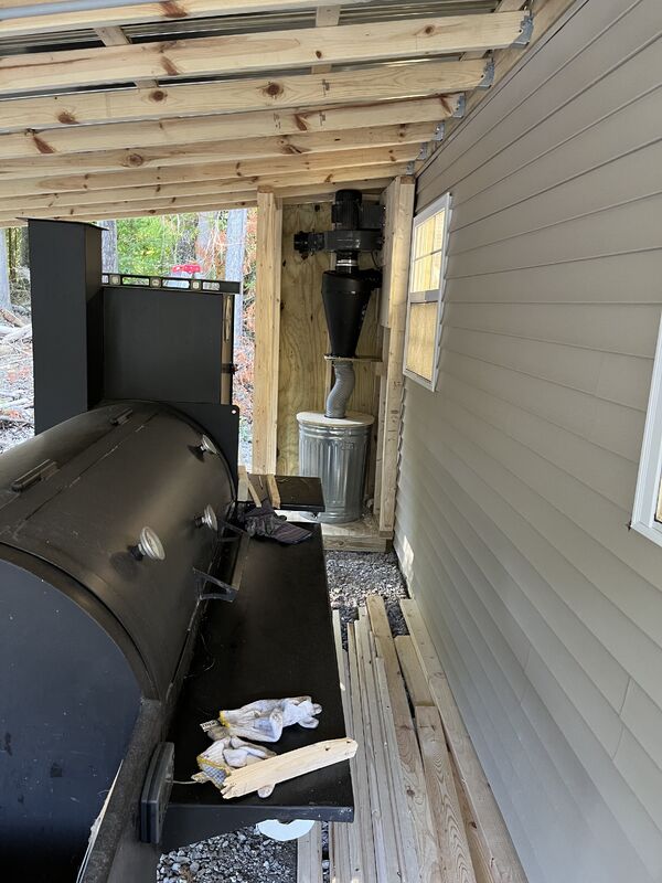

When I built my shop, I put the dust collection system outside then ran 4” thin wall PVC around the upper walls making sure not to have any 90 degree bends.  I really like having the dust collection outside both for the noise reduction and emptying the can.  IMG_3958.thumb.jpeg.45dd23868161ae566b34ca5d7f96d4ac.jpeg
Gordon- your setup looks great. I'll have to go inside with the unit although I see many benefits of the outside setup for noise, emptying, and heat generation.

@Gordon...knowing how cold your region can get and with your unit in a "open" climate setting do you experience any motor start issues or problems with frost accumulation or moisture transfer during the winter months?
That picture was taken during the construction phase, it is now completely walled in with a removable door and gaps filled with either spray foam or chalk. That said, it is not heated or any climate control. The motor and blower unit is an harbor freight system. So far I haven’t had any issues with it. Also, since I don’t have any neighbors near by and the shop backs into the woods the fan is vented straight out using a dryer vent. I think the lack of an exit filter gives me a slight advantage in vacuum.
Other notes, if you’re looking to build a lid for a trash can as I did here, it’s two plywood circles, inside and outside. Since the can isn’t a perfect circle I had to make the inside circle about an inch smaller and used foam weather strips. I ended up installing some latches as gravity wasn’t enough to keep a seal.
I use it all the time, many days with negative temperatures and no issues (so far) and I’m very happy with it.

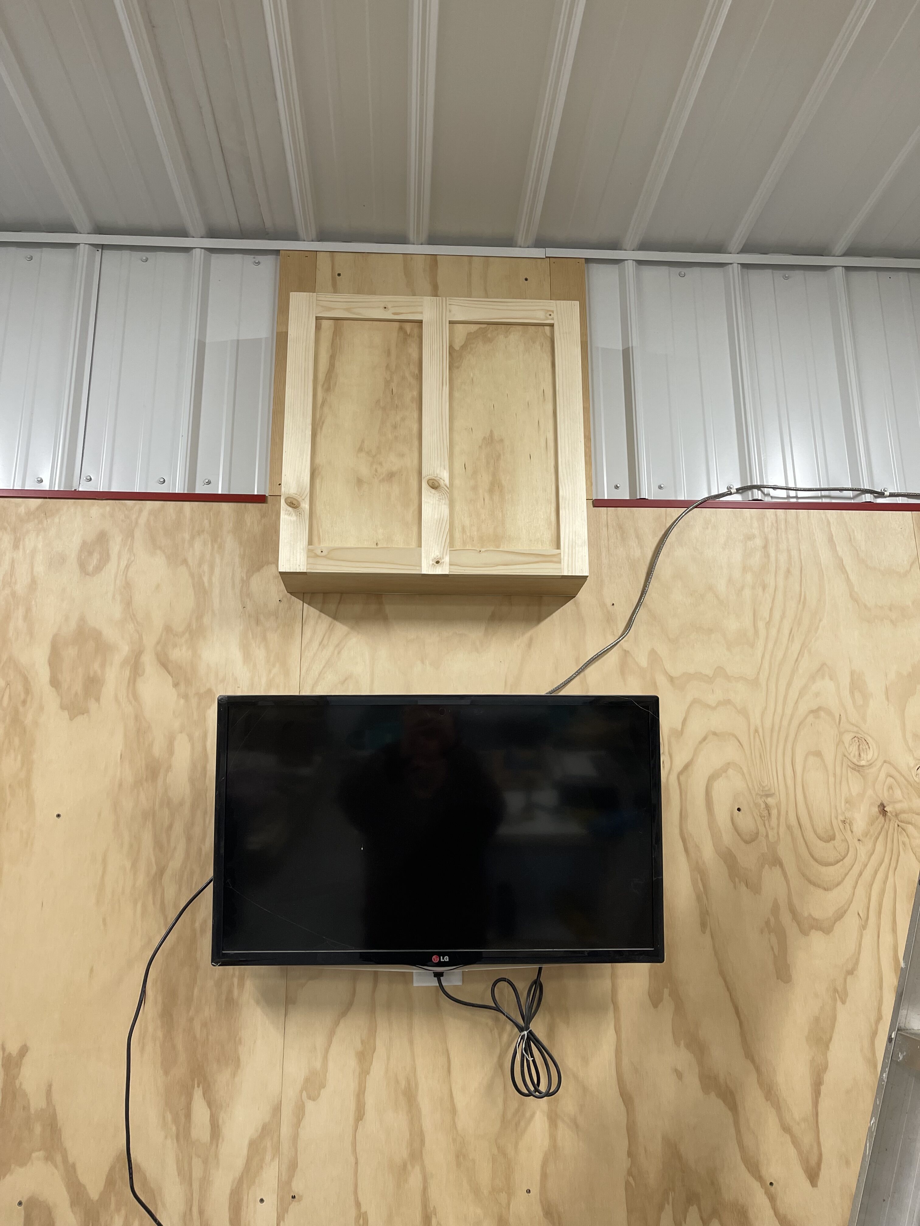

When I built my workshop, I installed a louvered exhaust fan in the wall.  It is controlled by a switch for now. The good news is it removes the fine particles. The bad news is it also takes the conditioned air with and I have to open a window or door to effectively exchange the air. I also had to build a cover or lid to provide insulation.  Also, in my infinite wisdom, that was also the location of my TV. Hindsight is always 20/20.
