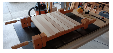

 I started by cutting up eight 2-5/16" wide x 20" long pieces on the table saw. Four out of Cedar and four out of Pine. I then used one of my shooting boards and hand planed each side edge of the 2 - 5/16 wide lengths down to 2 - 1/4".
Step 2
Then I setup up in the clamps for the first glue up. Alternating back and forth with the Cedar and Pine lengths... one Cedar.. one Pine... then Cedar, etc.
Now...I have to let the glue dry overnight. Lol.

It's now dry, so I removed the clamps. I used a card scraper to remove any glue lines and surface imperfections. And then I had a Pine / Cedar 18" x 20" sheet. The extra 2” was to allow for kerf width loss. Then I put this back on the tablesaw and using a very good Forrest blade, cut into 2-1/4" lengths across the alternating Cedar/ Pine sheet.
 After cutting and cleanup etc., I then flipped every other length, glued, and put back into the clamps.
 When dry the clamps were removed and then the board was finessed  to a final size of 18" x 18".

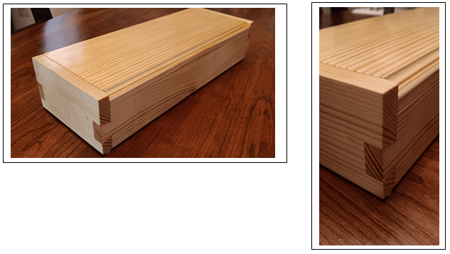

.... So I made a separate box...
It has a flush lid. Again with a Classic Ogee profile on the front edge of the lid.
This matches the Chess board. It also has dovetailed corners and a flush hinge on the back.
Like the Chess board it was French polished with blonde shellac.
Lastly, I did a blue velvet inlay for inside bottom.
Here’s an inside view with chess pieces stored.
