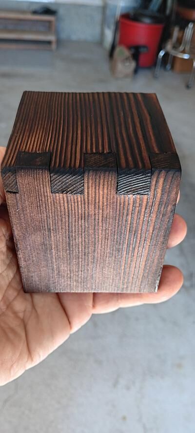

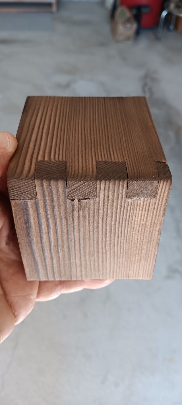

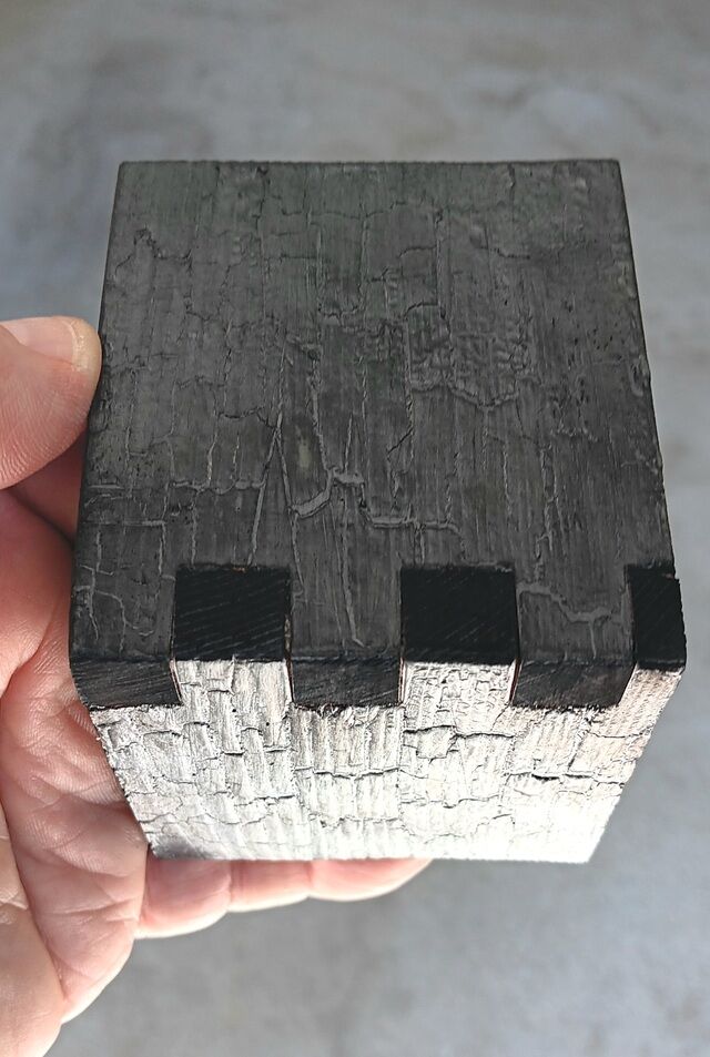

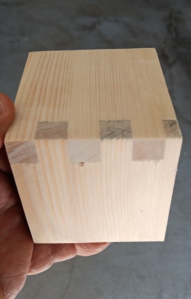

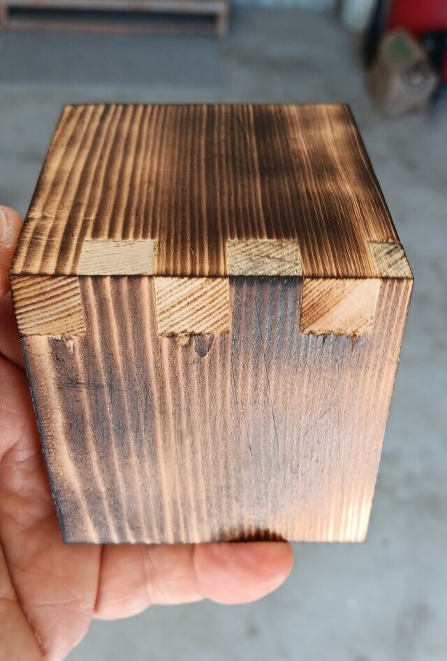

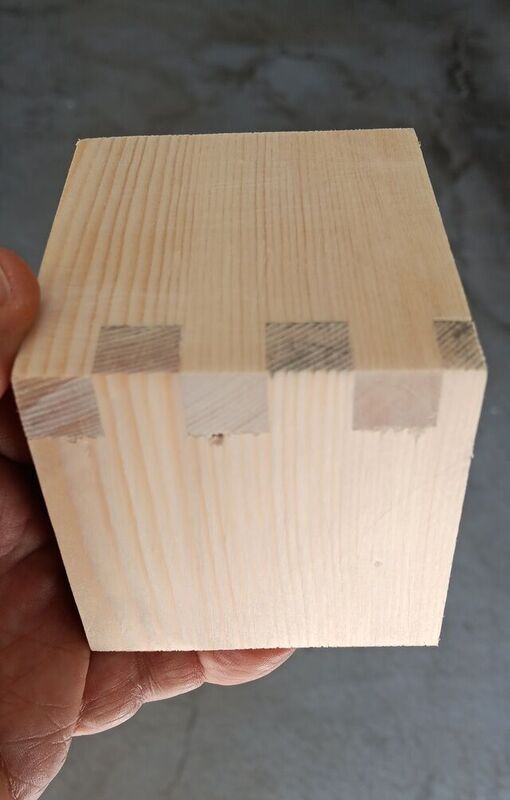

Popular Post MrRick Posted November 19 Popular Post Report Posted November 19 Just a play on words! So I've done Yakisugi (Shou Sugi Ban) on a number of boxes, etc. which I've shared with all of you. So now I was thinking how would this look on a box finger joint box? I experimented first doing a corner. The idea is to do it in stages and record each with a photo. This way I can select which I like best for my project. Here for the 1st stage is the corner with the Box Finger Joints assembled and sanded. It's not 100% perfect but good for this test. For the 2nd stage I did a surface burn. Controlling this burn could be desirable. Then this 3rd stage is a deep burn "alligator skin" For the 4th stage I brushed it off and it looks like this. You could leave it like this or decide to wax or oil it. On the 5th and final stage of this experiment I put one coat of 1 lb shellac on it. Doing this experiment is important because I now know what to expect in selecting one of these stages of Yakisugi (Shou Sugi Ban) on a box finger joint box. Cheers! MrRick lew, HandyDan, Gerald and 2 others 4 1 Quote

Grandpadave52 Posted Saturday at 05:35 AM Report Posted Saturday at 05:35 AM Thanks for sharing the progressive steps Rick. So which is your preferred look? I personally like how it looks at Stage 4...at least on the pine. No doubt other wood species would give different appearances. Quote
MrRick Posted Sunday at 05:56 PM Author Report Posted Sunday at 05:56 PM Thanks Grandpadave52. I like both the 4 and 5. But lean towards 5 because it has a finish. Grandpadave52 1 Quote
