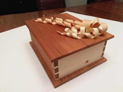

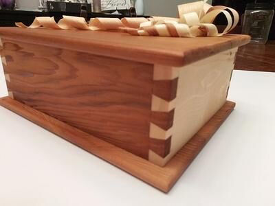

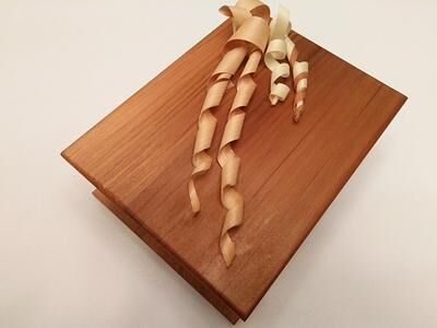

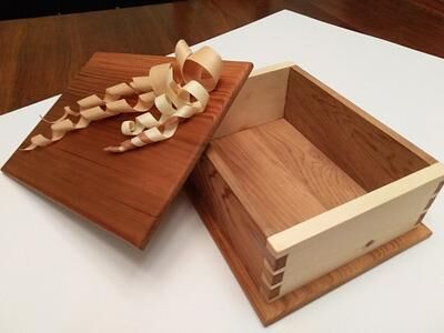

November 14, 2025Nov 14 Popular Post comment_365303 Made this special gift for my sister's birthday. Box and Ribbons made of Pine and Cedar. All done with hand tools only. I did hand cut dovetails on all four corners. The lid and bottom were radiused by hand plane. The ribbons were made with a Stanley Bailey No.3 smoothing plane. Just look at that grain! Just awesome wouldn't you say?! Thanks for looking!! Cheers! MrRick Report

January 23Jan 23 comment_369500 I came across this older discussion and wanted to add that the hand-tool work here is really inspiring. I’m curious how long the shaping of the ribbons took with the No.3. Did you run into any tear‑out on the Cedar? I’ve been trying similar decorative work and keep fighting grain changes. Report
January 23Jan 23 Author comment_369513 3 hours ago, Mstatosh said: I came across this older discussion and wanted to add that the hand-tool work here is really inspiring. I’m curious how long the shaping of the ribbons took with the No.3. Did you run into any tear‑out on the Cedar? I’ve been trying similar decorative work and keep fighting grain changes. Thanks @Mstatosh! Glad you like it! Making the ribbons only takes a few minutes. When I first developed the technique for making these ribbons, I had a little tearout out. Three things are very important. First... Make sure your plane blade is very sharp! I mean really really sharp. Second... Take a fine set on your plane depth. Experiment to get the right set is important. Very little protruding blade. Third... Yes... grain direction when laminating the blanks to cut these ribbons is also important. You'll get it. Keep at it. Also when you make your pass with the plane, position it at an angle. Skew it. Cheers! MrRick Edited January 23Jan 23 by MrRick Report
