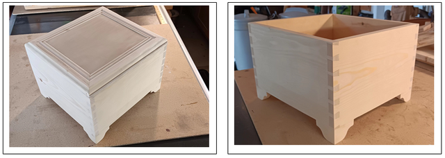

So, I built another box to hold my custom moulding planes. It's made out of Pine. My first one only holds 8 planes. I designed it to fit nicely in my shop upper cabinets.
I now have made 11 custom moulding planes. Half of them are various sizes of Hollow and Round moulding planes. The rest are Beading and Ogee Moulding planes and one rabbet moulding plane.
Before I get into here, I want to mention that this entire box was done with hand tools only. All of it. From cutting up the stock to the finished completed box.

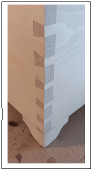

I started by making a handcut dovetailed box with feet. Just like the first one.

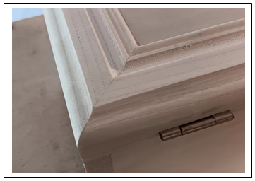

After it was assembled, I started making the lid. It is made up of a center piece framed by custom moulding that I made with my various moulding planes. This is different than the first one but similar. The first one had a Shou Sugi Ban center and the custom moulding was different.
The mitered frame is 3/4" thick x 1-3/4" wide. I made it using three of my moulding planes. The Ogee, Hollow, and Side Bead.

Here’s a corner detail of the  handcut moulding.

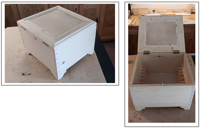

Next, I glued in the mid section. After this was done, I installed the brass hinges for lid and body.
I also added a centering pin for the lid. This will always center the lid to the box even if there is misalignment for any reason.
Here are views of the completed box. Note in the first photo the indiscreet dowel I added for the handle (zoom in). I did this with my first moulding plane box and it looks nice.

Love those hand cut dovetails!
Pins or tails first?
Glad you like them lew! Tails first always.
