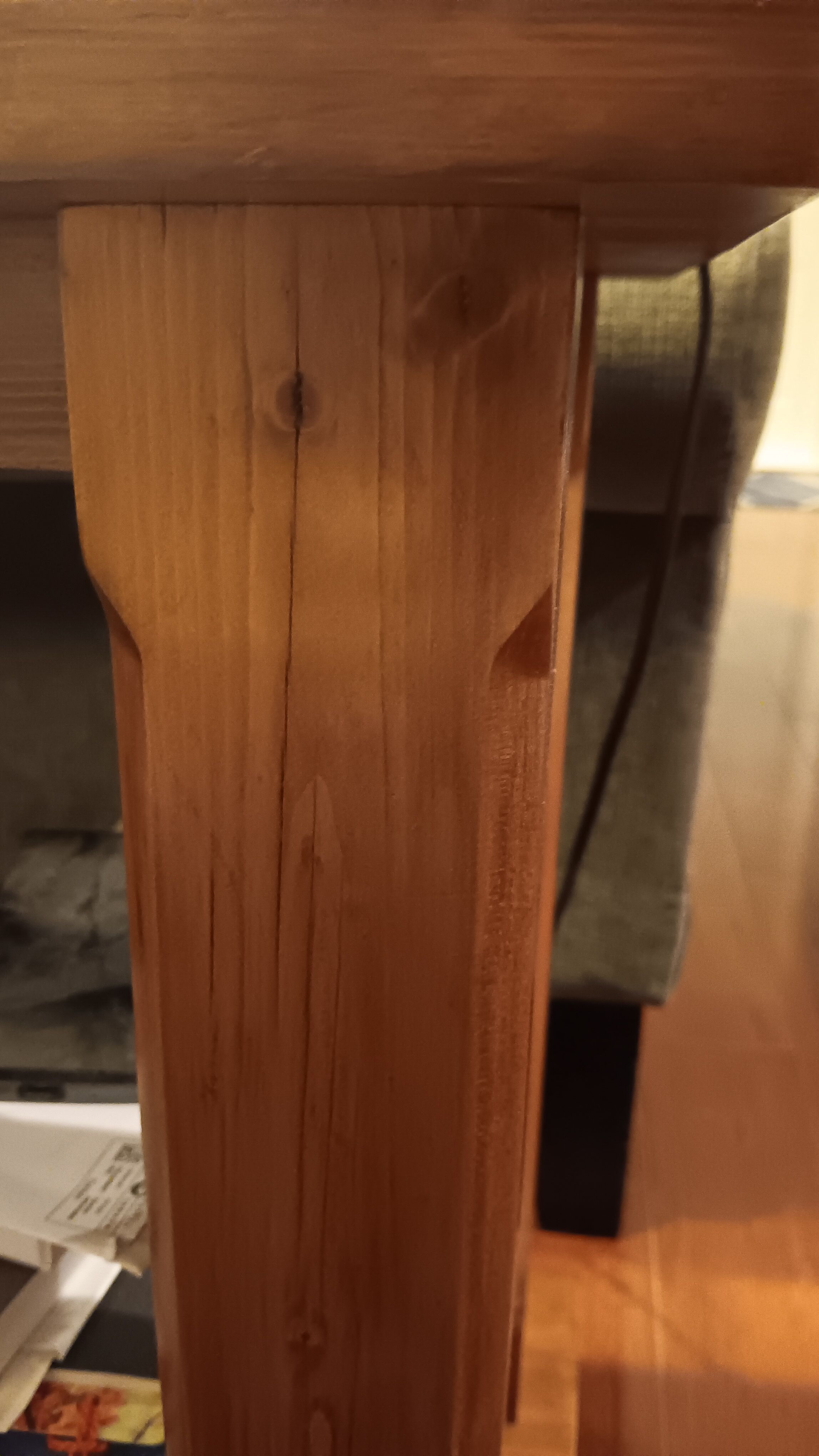

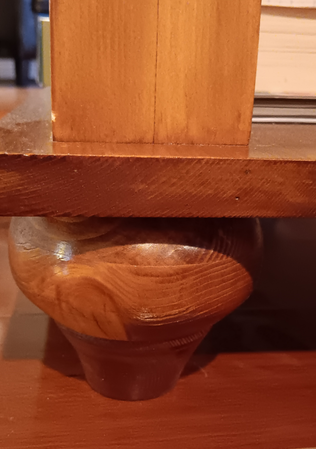

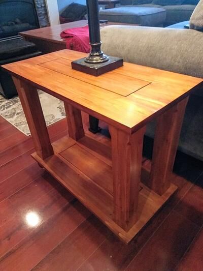

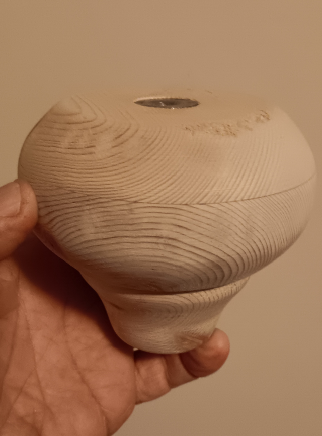

October 28, 2025Oct 28 Popular Post comment_363994 I made this end table out of Pine a couple of years ago to match our other furniture. It has a General Finishes medium brown dye stain and top coated with a General Finishes water based polyurethane. I didn't have a lathe so I made the bun feet by a special jig on my drill press. Here it is and ready for finishing. Here it is mounted in place On all four corners of each leg and made stopped chamfers Hope you like it. Thanks for looking! Cheers! MrRick Report
October 28, 2025Oct 28 comment_364018 Yep, a drill press is just a lathe standing on end. 😉 Well done! Report

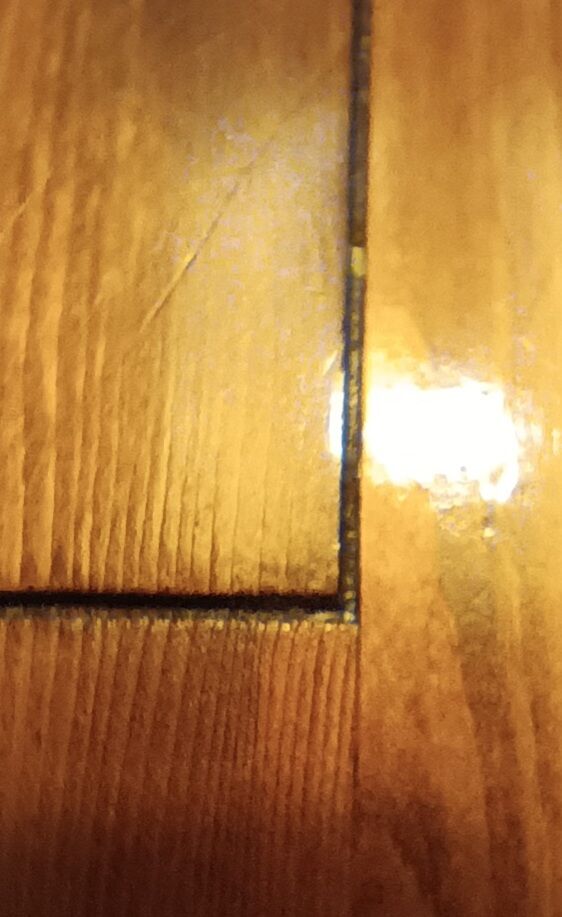

October 28, 2025Oct 28 comment_364019 Looks really nice. How did you add the detail in the middle of the top and the shelf? Is that raised, or a groove to give that visual? Report
October 28, 2025Oct 28 Author comment_364023 1 hour ago, 4DThinker said: Yep, a drill press is just a lathe standing on end. 😉 Well done! Thanks 4DThinker. I've done alot of turning on my drill press but I'm always careful not to damage my quill by making sure both ends are secure. Report
October 28, 2025Oct 28 Author comment_364025 1 hour ago, BB1 said: Looks really nice. How did you add the detail in the middle of the top and the shelf? Is that raised, or a groove to give that visual? Thanks BB1! It is a groove. The top is made of 5 pieces. The middle piece is rabbeted all around so that the rabbeted edge is inline with inner edge of long left and right sides and top and bottom middle pieces. Here's a close up. I'm I explaining okay to you? Report

October 28, 2025Oct 28 comment_364035 1 hour ago, MrRick said: It is a groove. The top is made of 5 pieces. The middle piece is rabbeted all around so that the rabbeted edge is inline with inner edge of long left and right sides and top and bottom middle pieces. Here's a close up Thats a great way to create added visual interest. With the added color of the stain it gives a feeling of a depth change. Report
October 28, 2025Oct 28 comment_364036 One thing about open grooves on a table top is that the detritus of life tends to make a home in them. 😞 Report
October 28, 2025Oct 28 Author comment_364037 23 minutes ago, 4DThinker said: One thing about open grooves on a table top is that the detritus of life tends to make a home in them. 😞 That's a fair comment. But then that's why you dust or vacuum now and then. Really.. it isn't very much trouble at all. Grooves less than 1/8" wide are recommended. Plus I meant to mention they are less than 1/16" deep. Report
October 28, 2025Oct 28 Author comment_364038 58 minutes ago, BB1 said: Thats a great way to create added visual interest. With the added color of the stain it gives a feeling of a depth change. You're quite right. It's subtle but inviting. The color provides some warmth. We like it. Report
