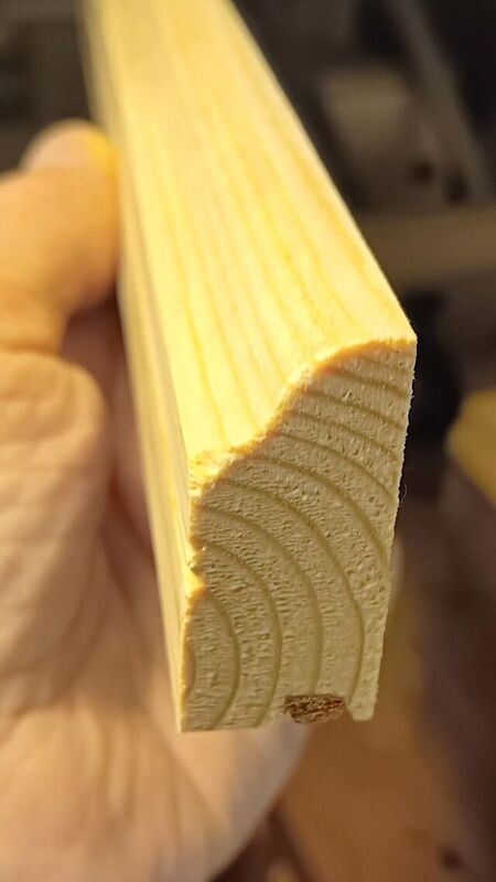

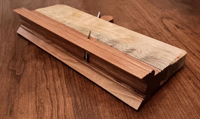

Popular Post MrRick Posted October 27 Popular Post Report Posted October 27 (edited) This is a Classic Ogee plane that I made. It worked well but a little difficult to use because I originally made it as an "unsprung" plane. It's now a "sprung" plane. I reworked it improving the fence by lengthening it on bottom left side and also lengthening the depth stop on bottom right side. On the nose I scribed in the "Spring" lines. This is how the user tilts the plane while using. You are looking at the nose here. The fence is on the right and the depth stop is on the left. It now works very very well! Here are some photos of the profile it makes. The first photo shows the actual profile it cuts. Here, I've cut the Classic Ogee profile on top and bottom along with some beading. On top I added a strike button Here's a bottom view Thanks for looking. Cheers! Mr Rick Edited October 27 by MrRick Gunny, JWD, lew and 2 others 4 1 Quote
