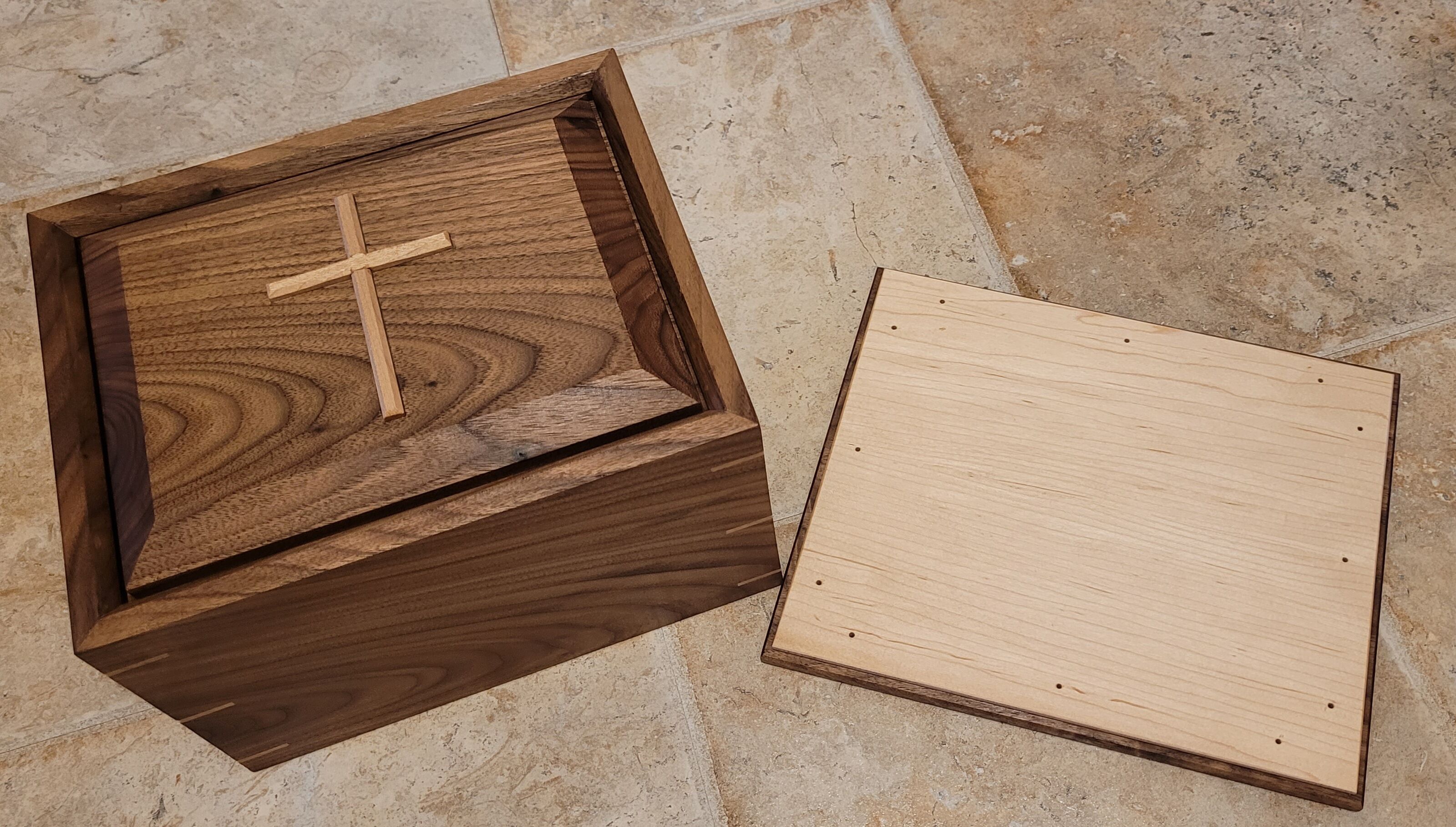

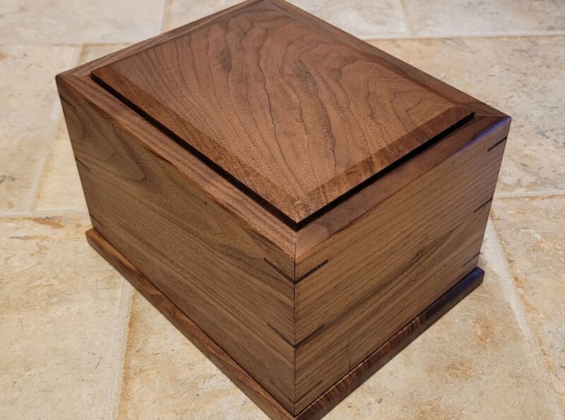

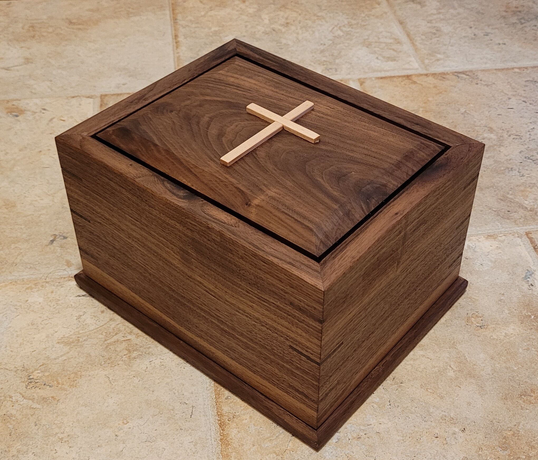

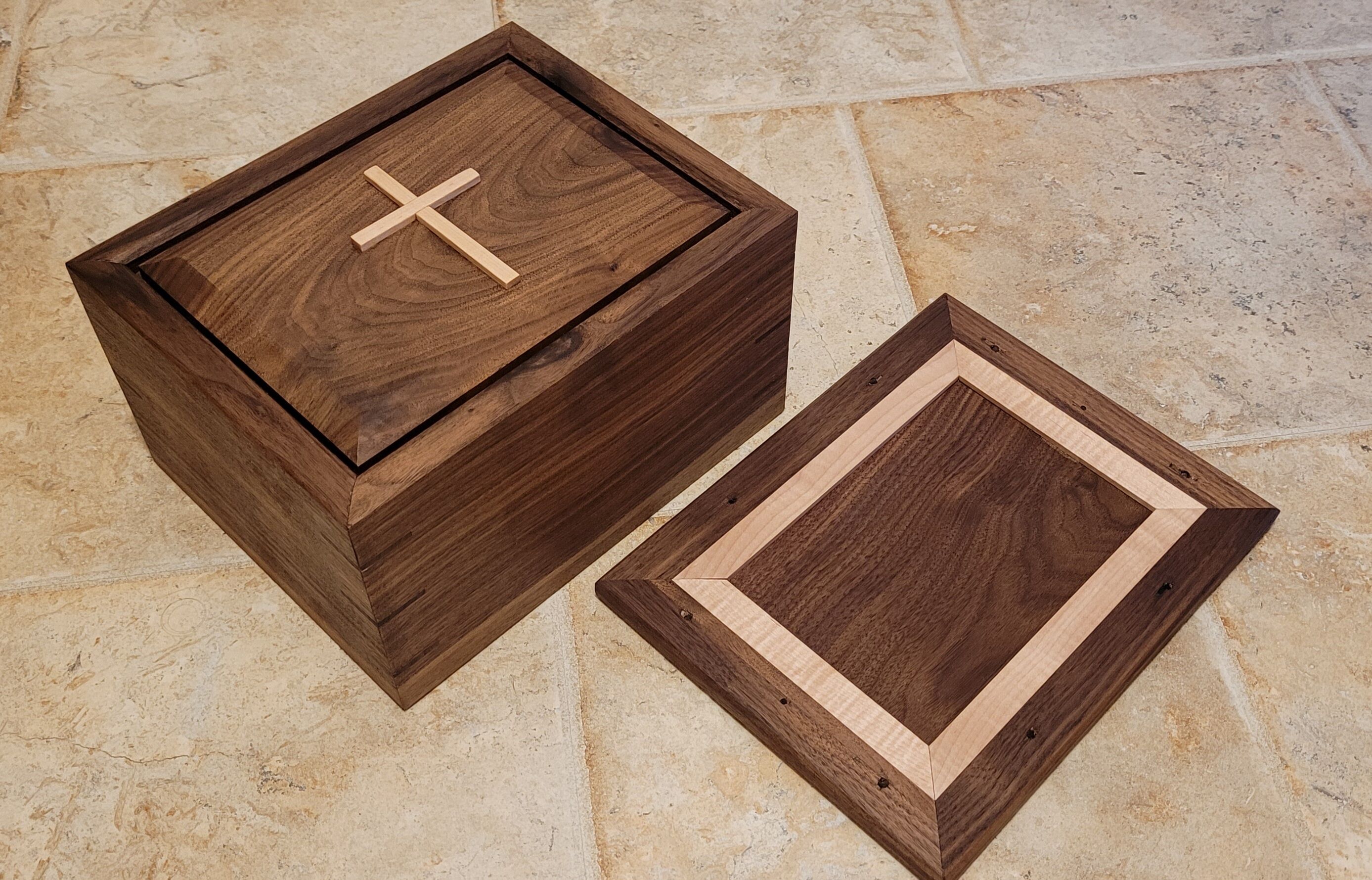

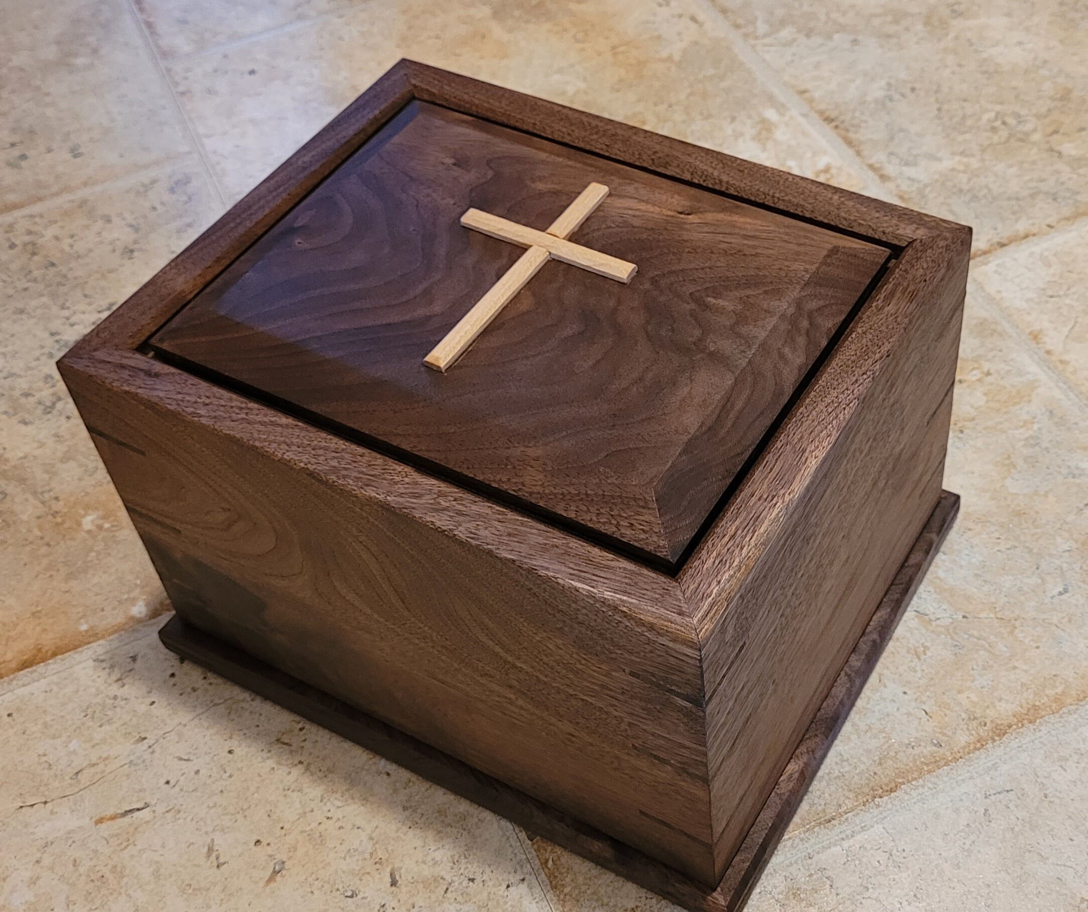

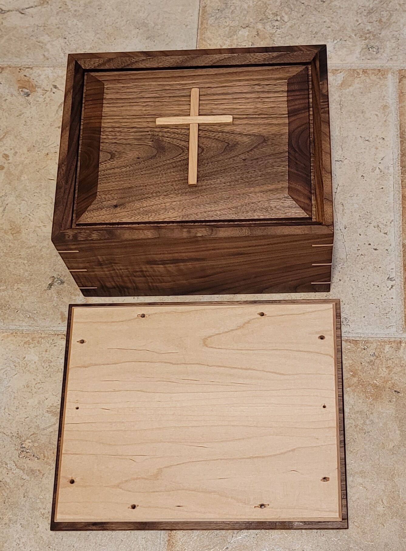

Popular Post BB1 Posted October 26 Popular Post Report Posted October 26 New to this site and thought given the focus, I would share some projects that have led to some donations for veterans. Earlier this year I decided to make my own urn. No current health concerns so more of a “planning ahead” situation. My favorite wood is walnut, so that was an easy decision on raw materials. I did quite a bit of background research on the size required, as well as what is allowed at the cemetery where this will be buried. I was able to purchase one of the temporary black plastic boxes from a local crematorium that is typically used to return ashes to families. I designed my urn so that this plastic box can just slide in from the bottom which is then screwed in place. The top has a bevel and is in a groove on the top to allow for wood movement. I used space balls to help center the top and then only glued in the middle of the ends. I finished it with Odie’s Oil which is my favorite on walnut. When I finished mine, my husband asked me to make his as well. He picked out a beautiful walnut board and I was able to do a resaw to allow a four-corner grain wrap. This did leave me with thinner boards than was ideal, so I added walnut to the top and bottom to allow for a groove for the top and then sufficient surface to screw in the bottom. He liked the contrast with maple so his urn has some added features, plus a cross on the top. After these, I also built one for a good friend. She took features from the prior two and the outcome was nice – also walnut with some really pretty grain. I have wanted to use my woodworking for others, and I contacted a local group that works with veterans. Although not something they normally had provided, I offered to make some urns and they were receptive to that idea. One I made from boards I had on hand. Another one was made with some walnut that a local mill donated. Having lost my dad (a veteran) a few years ago, I know how overwhelming all the decisions can be related to final arrangements. I’m hopeful these urns can be given to families to ease some of the financial burden. Anyway, that’s a peak at some of my more recent projects. I’m currently reorganizing and repairing a pole barn that will allow my shop area to expand. I have found that I’m more into woodworking than construction (haha…some water repair and getting a wall “redone” where an old AC unit was pulled in prep for a new minisplit has been a challenge!!). Looking forward to exploring the content on this site and being involved. Please let me know if this post is appropriate or in the right place. Headhunter, HandyDan, lew and 4 others 4 3 Quote
Fred W. Hargis Jr Posted October 26 Report Posted October 26 Wow, those are really nice. I especially love the 4 corner grain wrap you did one the husband's urn. I am looking for urn ideas at the moment, but for a pet instead of a person. As for the correct forum, I'm not sure how this couldn't be the right one but I'm not the decider. Also: welcome to the forum. BB1, Grandpadave52, Headhunter and 1 other 4 Quote
Popular Post BB1 Posted October 26 Author Popular Post Report Posted October 26 Thanks Fred! I agree that the grain on my husband's is really nice. I had lined up the walnut boards I had to let him pick - and his selection sure proved to have a really distinct grain pattern that worked out so well for the urn. Note that from my research, each 1 pound equates to 1 cubic inch. Hopefully that's helpful as you construct your pet's urn. lew, Fred W. Hargis Jr, Headhunter and 2 others 4 1 Quote
