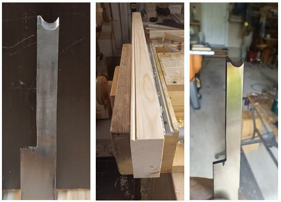

It’s now far enough in the build that the blade needs to be made. I assembled the rough cut out blade stock into the plane so that it was just poking out of the mouth and scribed the bead and quirk outline on it.
Next, I setup my homemade forge. I showed this in a previous post. I then annealed the blade to remove the hardening.
Next, I cleaned up the blade and gave it the first grinding, shaping and honing.  Then I re-hardened the blade. Before going too far, I wanted to make a test cut to make sure I had made a functional plane. I didn’t want to push cutting too much because the blade at this stage is brittle. The test cut was very pleasing. Then I fired up the forge again and tempered the blade. A straw color means it’s perfectly tempered. It softens the steel a bit and readies it for final honing.
Lastly, I did the final honing to the blade. I used my DMT Diasharp diamond stones 600, 1200, 8000 and final polishing with a Shapton Ceramic waterstone 16,000. It came out very very sharp! Then a quick final test cut pass confirms the blade is ready for use!
