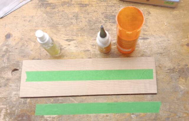

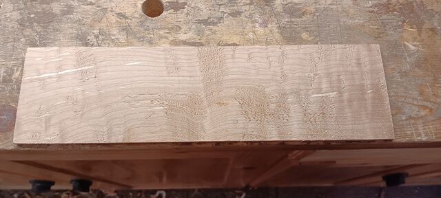

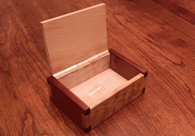

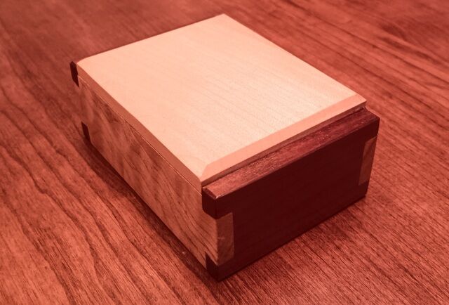

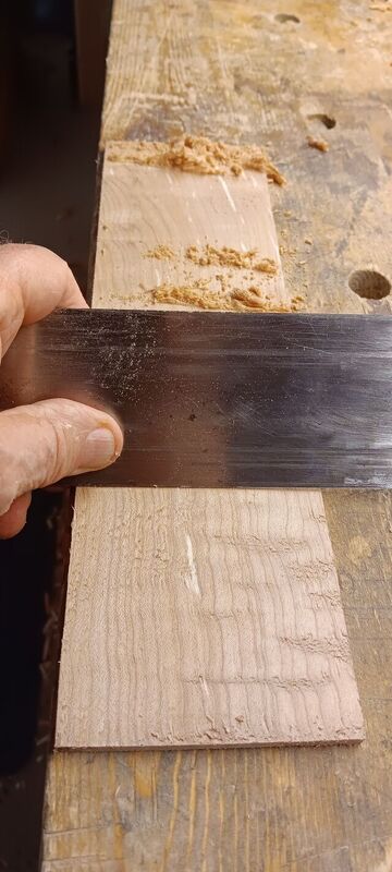

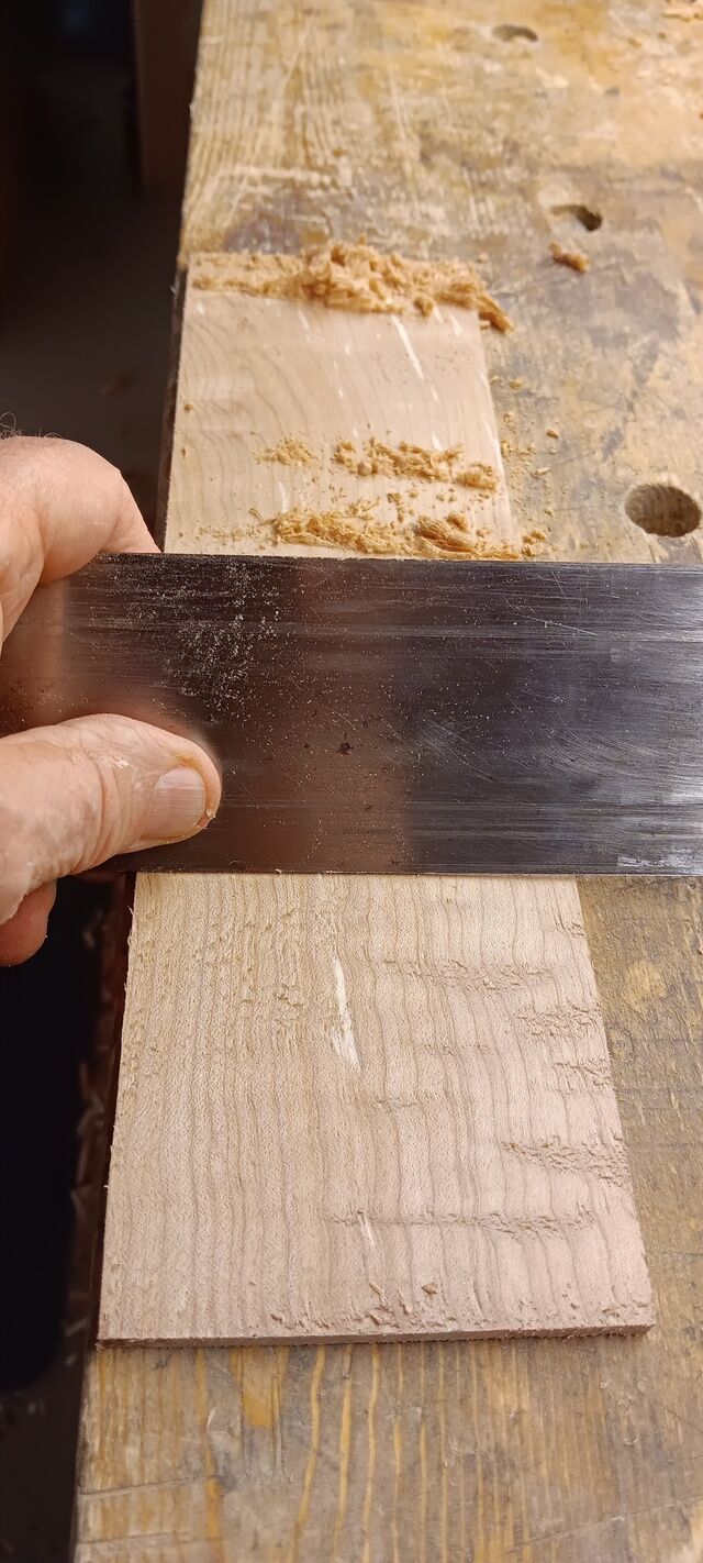

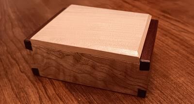

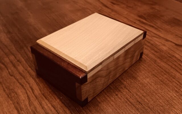

September 22, 2025Sep 22 Popular Post comment_361996 Introduction ... Originally I made this as a Business Card Box for a friend who is always helping others. Then it dawned on me that it also would make for an attractive ring box. So I'll probably make another as a ring box. The making ... I started by planing and card scraping some 5/16" and 3/8" thick stock. The top and back will be 3/8". I adhered thicker stock to my bench using the CA glue and painters tape technique shown here. Place tape on bench and stock Next place a bead of CA glue on bench tape and accelerator spray on the stock tape. Then start planing and scraping Details ... The box has hand cut dovetailed corners and a flush hinge. The sides are Torrefied Maple. Top, bottom, front, and back are Spalted Maple. The hinge is Hard Rock Maple. I made the lid proud, chamfered and slightly pillowed. An inside look..... Thanks for looking!! Feel free to comment, ask questions and "thumbs up 👍" if you like it! Cheers! MrRick Report
September 22, 2025Sep 22 comment_361997 Great looking box. Love the contrasting wood design; gives it a very classy look. Since it will be a ring box do you plan to line with felt or apply a felt flocking? Report
September 22, 2025Sep 22 Author comment_362000 Grandpadave52... this one is the Business Card Box. I haven't made the twin yet which will be the ring box and it will have blue velvet liner. Report
