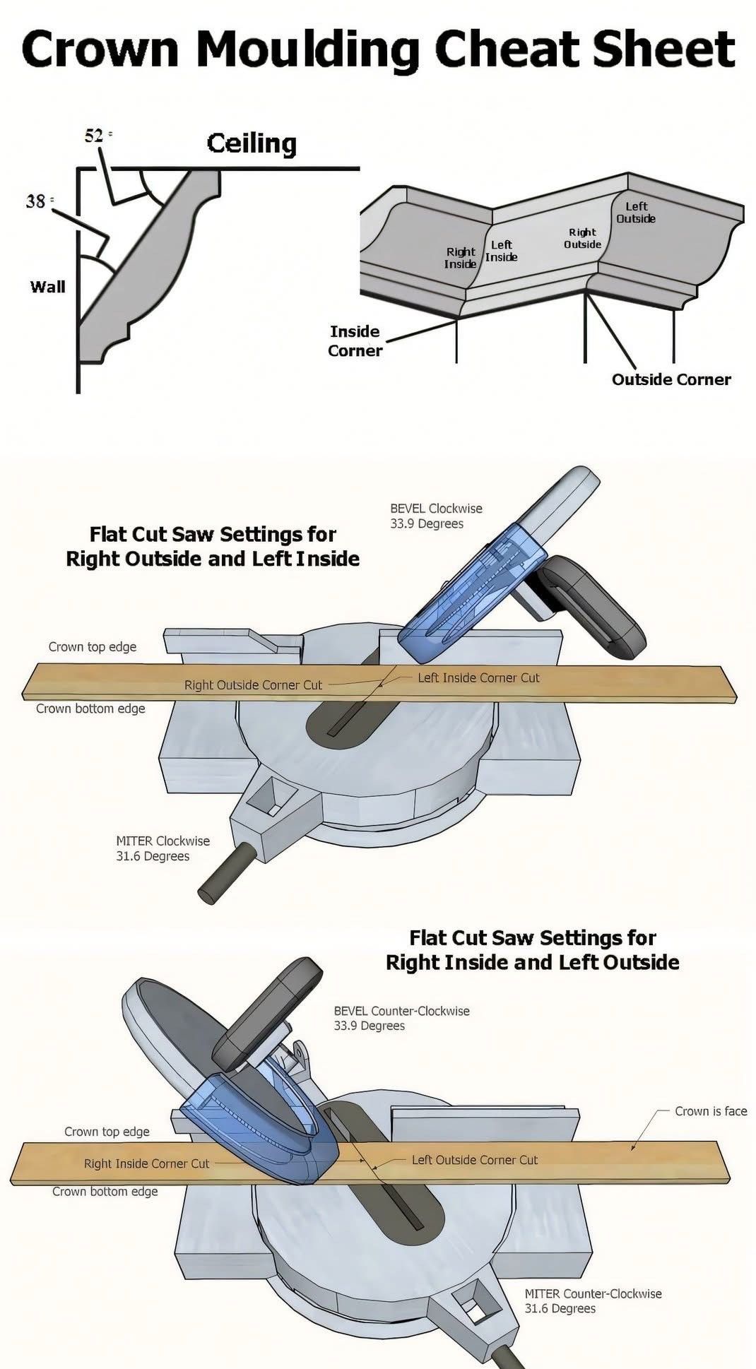

For those who aren't aware of this...
I used to try to stand the crown up against the fence-dangerous and not fun, especially with larger crown.
My miter saw only moves like the top image, so I had to do the other cuts with the crown upside down and the bottom edge against the fence.  A good blade will prevent tear out.

My preference is to hold the stock upside down and at the appropriate angle.  Make a jig to hold it if necessary.  Then you can just switch the saw from 45 degrees left to 45 degrees right (or whatever the corner angle is.)
