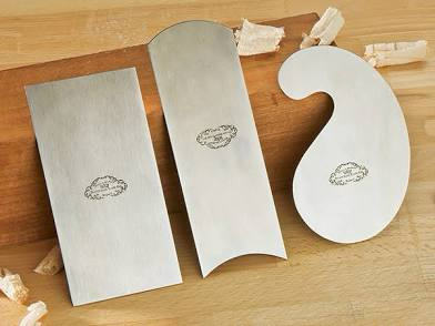

Ron Dudelston Posted August 12 Report Posted August 12 Welcome to the site. IMHO, I would leave the plane on the shelf and use cabinet/card scrapers. If the scraper is sharp you can peel the paint right off. Gunny, lew, Al B and 1 other 4 Quote

Woodworker Wanna Be Posted August 13 Report Posted August 13 The shelves are made of solid pine but there isn't an option of just flipping them since they have factory installed hardware that locks into a pin. I wish I could take them outside and chemically strip them but my landlord would have something to say about that. I hadn't thought about a scraper but trying to sharpen any tool like planes, scrapers and knives scares me. Inevitably I make things worse. How does one learn to sharpen their tools? lew and Al B 2 Quote

JWD Posted August 14 Report Posted August 14 My suggestion would be either sanding or a cabinet scraper. You can get scrapers with a prepared edge, and it would maybe last long enough to finish the job. Putting a burr on a scraper is tough, lots of people struggle with it, like sharpening. Any kind of planing and you'll need a sturdy bench to hold the work, without that planing is not feasible. Sanding is messy and tedious, but it's about the most approachable method. You could also try the orange stripper from HD or wherever. It uses terpene compounds from orange peel supposedly, and it has worked well the few times I used it. That you could use indoors, it's much less strong smelling and nasty than the heavy duty strippers. Al B and lew 2 Quote
ASteinfield Posted August 14 Report Posted August 14 Welcome! If your IKEA shelves are the typical particleboard with a laminate or veneer, a hand planer might not work well coz it can tear the surface or expose the crumbly stuff underneath. Instead, try a carbide scraper. It’s quiet, doesn’t make much mess, and works without chemicals. Way more apartment-friendly than sanding or stripping. If the shelves are solid wood though, then yea, a hand planer could do the job, just go slow and be careful Gerald 1 Quote
