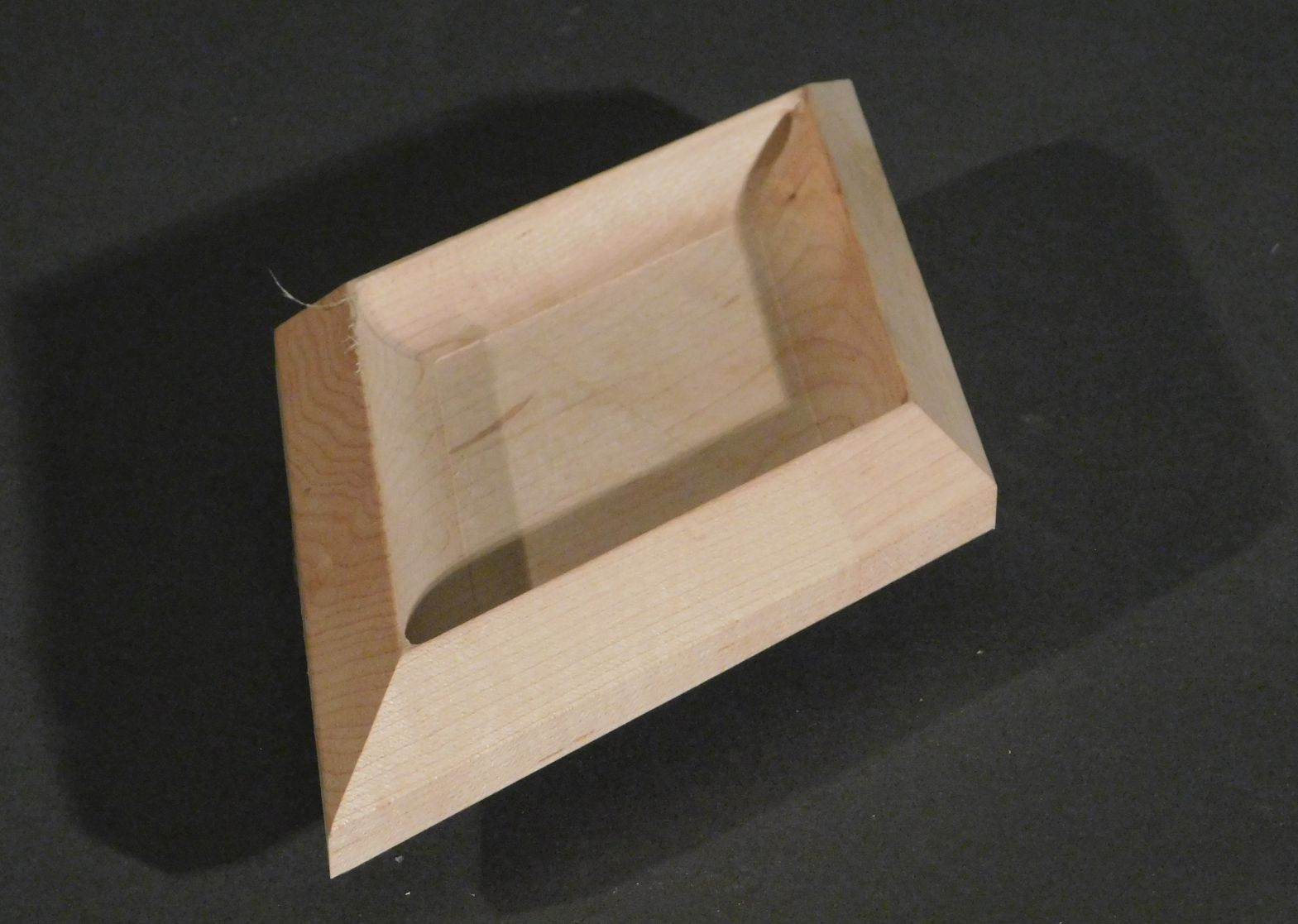

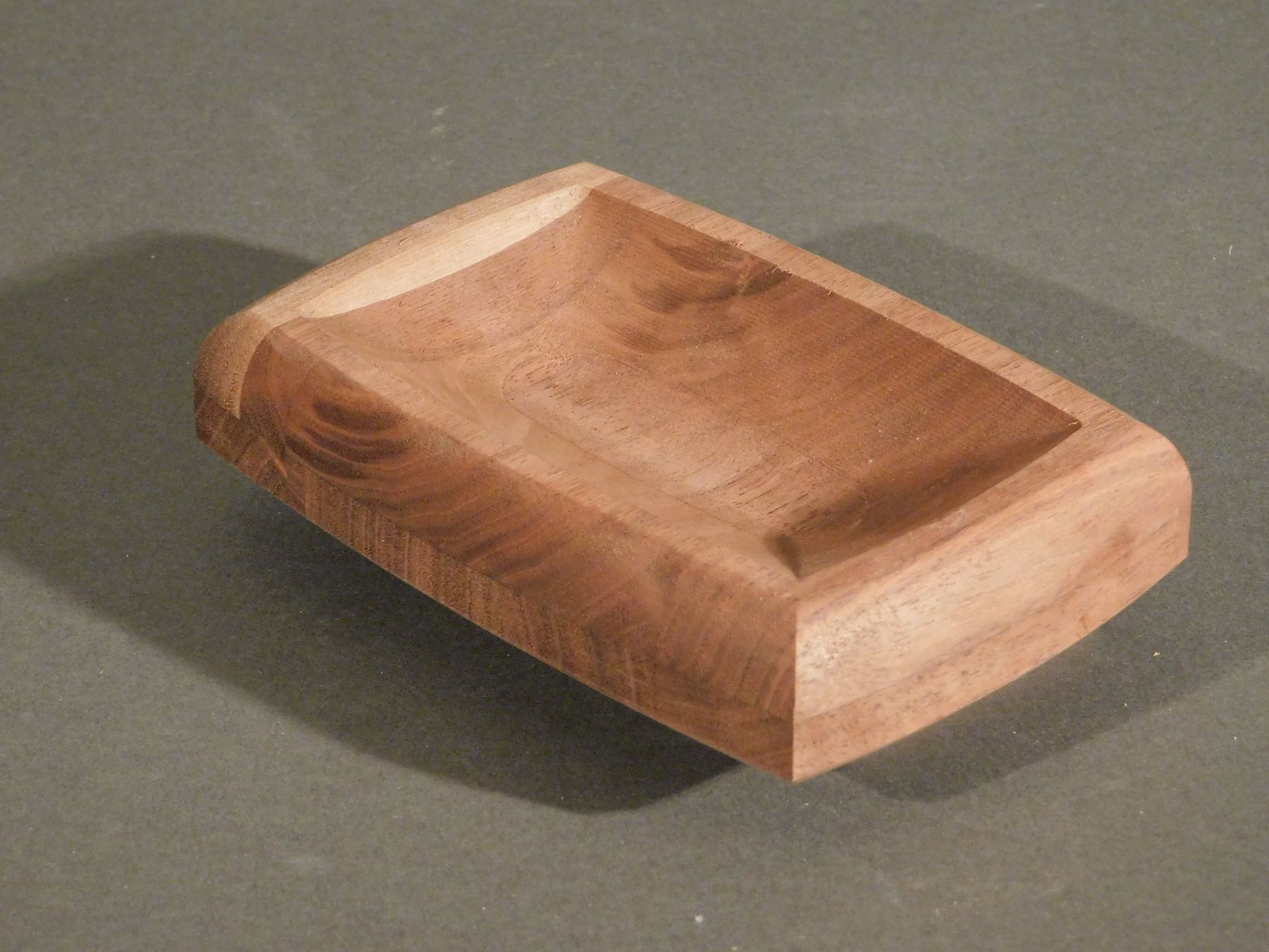

One more.  Rounded rectangle.  This one from several scraps of walnut. Add in a couple of walnut plugs to cover screw holes.  Might need some walnut stain to even out the colors.
The moulding toolpath in Aspire handled the outer oval roundover.  I had to use the modelling tools to create the dish in the center. There is a 45 degree chamfer on the bottom edge which doesn't show from this high angle shot.
4D

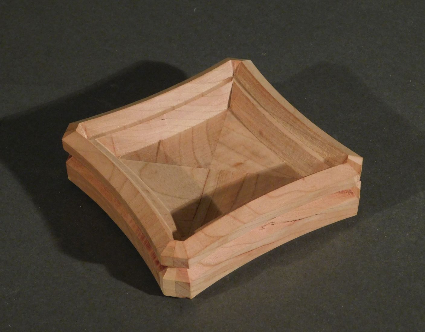

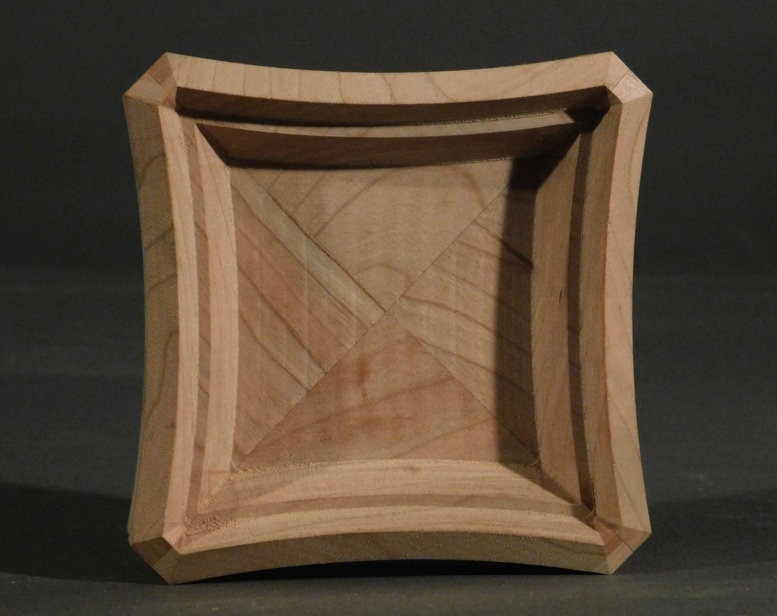

Another one.  This one from the corners of a round plant stand cutout. Shape roughly echoes the shape of the scraps all glued edge to edge.
Four bit changes required.  Started with a 3/16" end mill to rough out the center areas of the Vcarve toolpaths.  Change one to a 60 degree V Bit to slope the inside edges and make the sharp inner corners. Change two for a 3/16" ball nose bit to use the moulding toolpath to chamfer the outer edge 30 degrees.  Change three to a 1/4" end mill to cut a clearance path for the last bit and profile the shape leaving thick tabs on the corners.  Fourth change was to a side cutting V bit to put V-Groove around the side.
Once the CNC was done I trimmed off the perimeter waste using my bandsaw, then used a flush cutting bit to clean off the bottom edge.   Last a chamfer cut using my trim router table and a 45 degree chamfer bit.   Tedious steps making me wish I had an Automatic Tool Changer.   Of course all the bits used would have to have been loaded up first and Z zeroed out. Not bad if I always used the same bits. Sadly my projects vary so much that I don't.

This cherry dish was an adventure mainly from using the side cutting (thread cutting) V bit.  One pass on the line, leads in and out, with previous clearance through the perimeter material cut by a 1/4" end mill on the same vector.  Offset away from the edge determined by a drawn up elevation view and careful measurement of the side cutting bit. Entry and exit on an exposed edge.   This is the type of project I set up one day, then sleep on before actually cutting it out.  My dreams usually warn me where problems may be and wake me up to take care of them by adding a new toolpath or changing one.

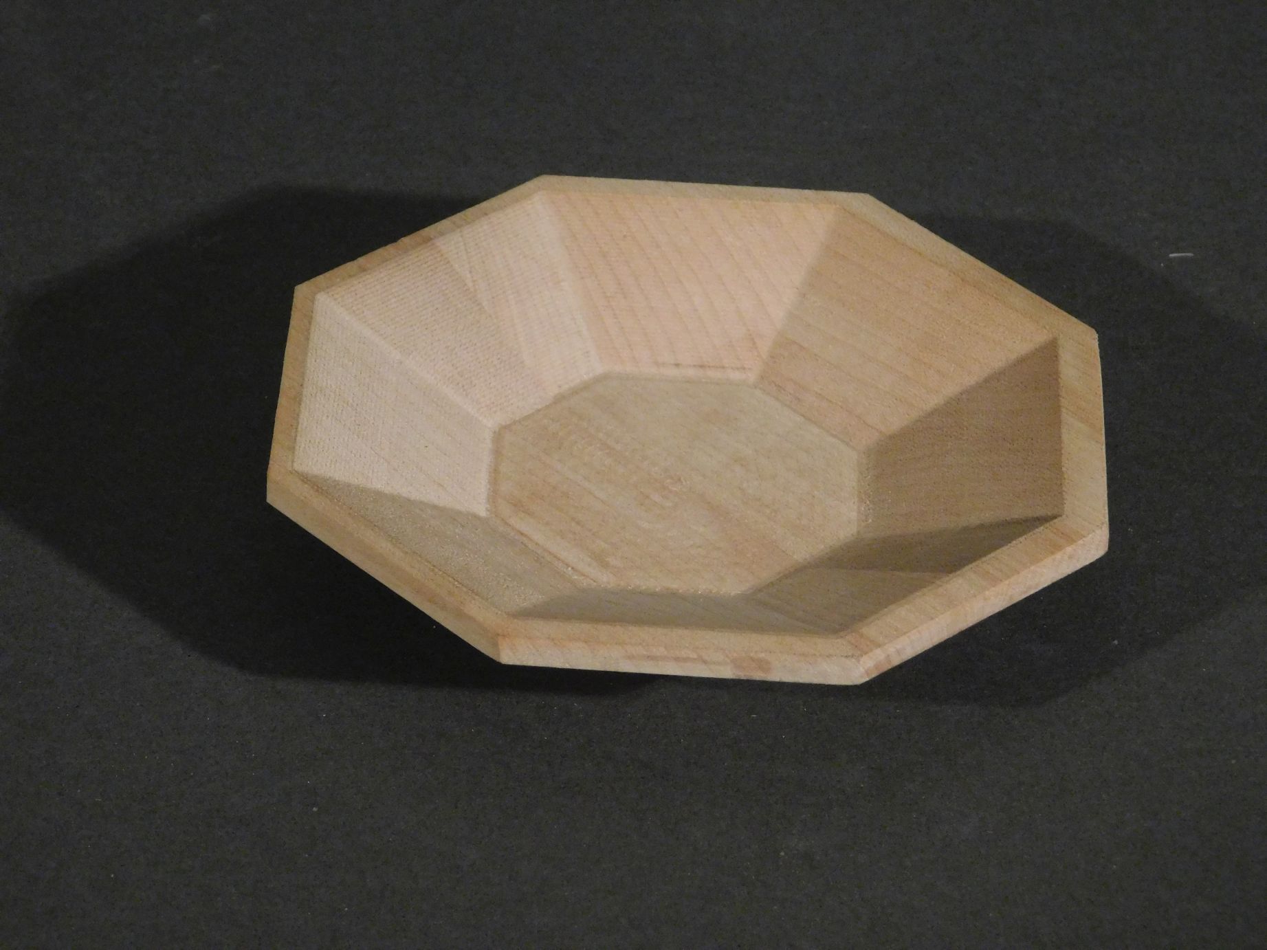

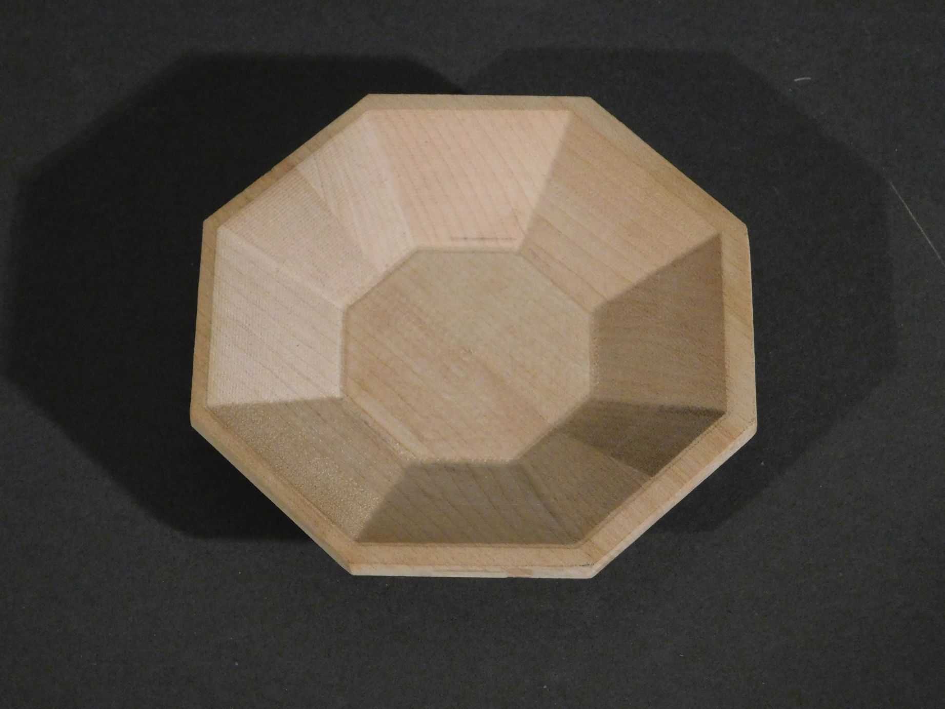

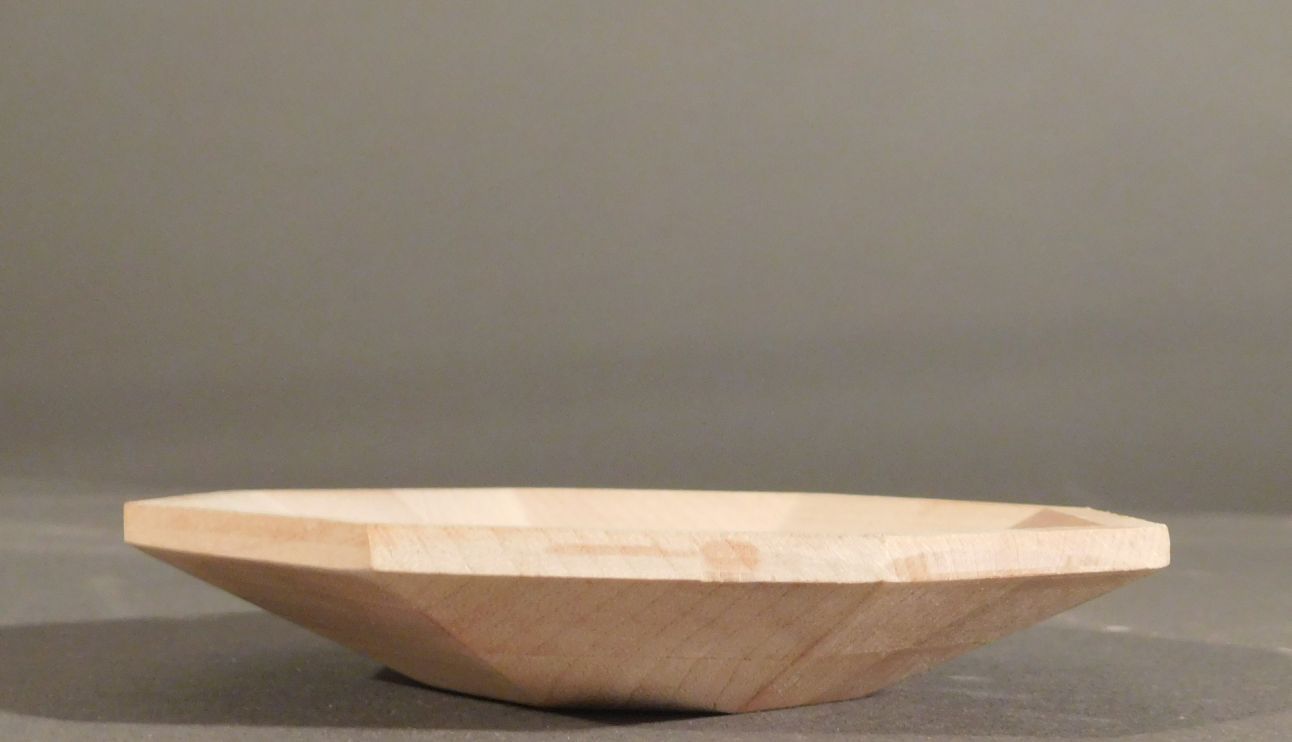

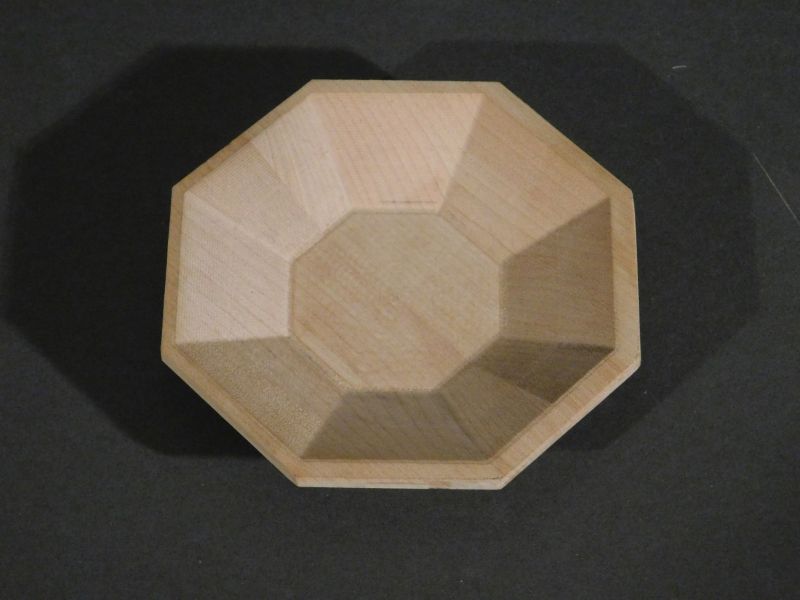

A little octagon dish.  One scrap cut in half then glued edge to edge to make 5" x 5" x 7/8" thick block.
3D modelling toolpath to shape the inside and outside.   Discovered a little math error in the 3D finish toolpath that left a little ridge on the outside slope.
Woke up and thought something more dish like would be a good challenge.  This little dish is practice. Hard maple scrap.  Most of it ended up as chips and dust.  😉
