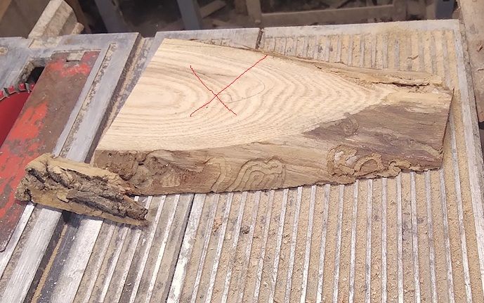

June 30, 20251 yr comment_358225 Hmmm, mine seemed to have left the building... Then people wonder why I don't do live edge work... Report
June 30, 20251 yr Popular Post comment_358226 15 minutes ago, steven newman said: Hmmm, mine seemed to have left the building.. I believe yours are from the Emerald Ash Borer. They bore under the bark but never enter the actual wood. Report
