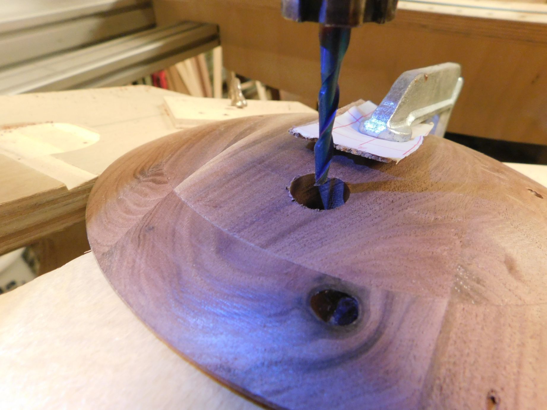

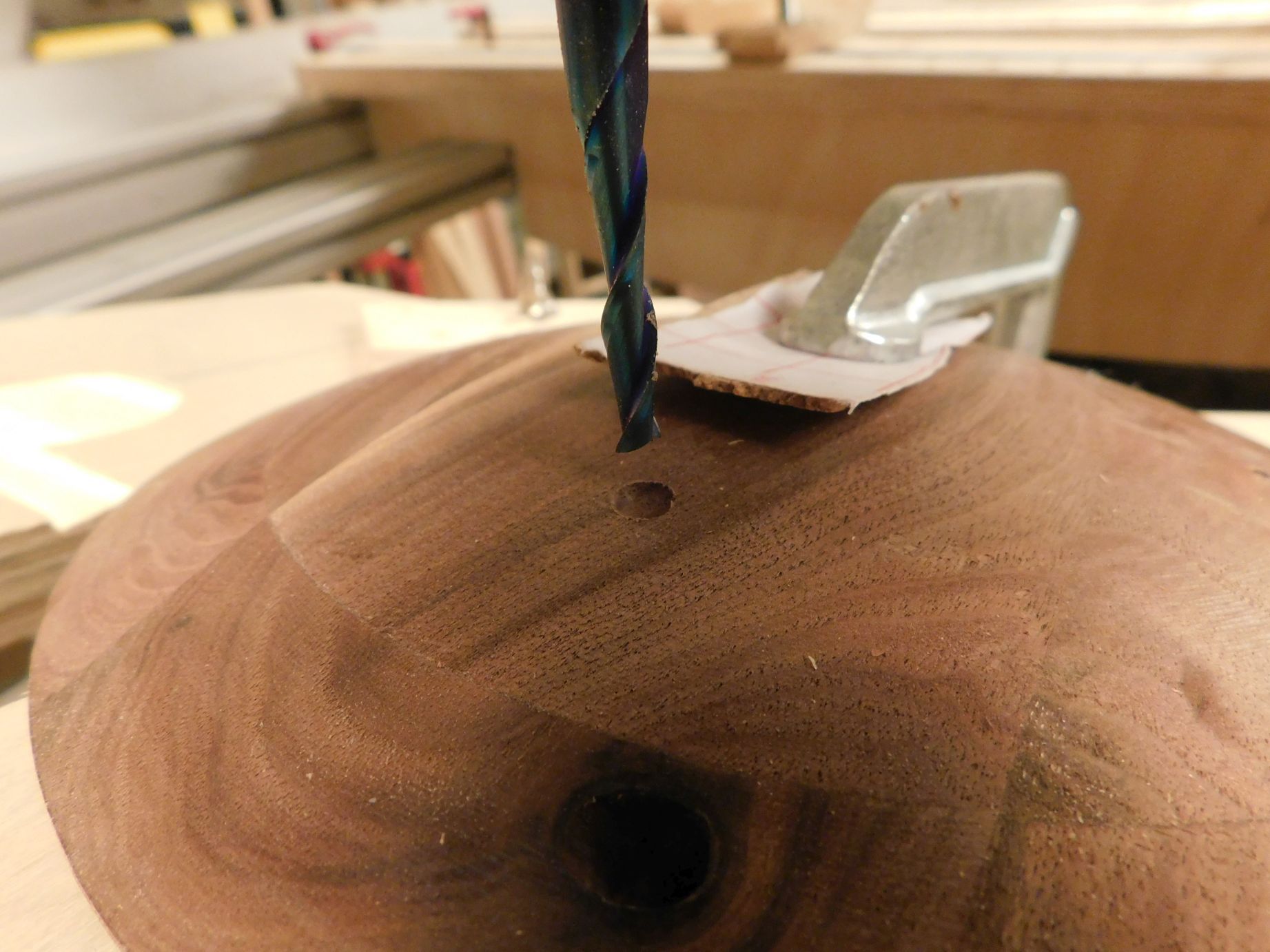

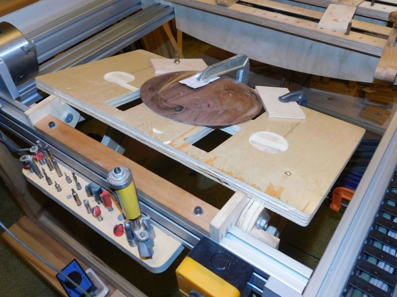

June 5, 20251 yr comment_357199 I had 4 short section of 5/8" diameter cherry dowel and a salvaged board of walnut that needed a project to be part of. I reconfigured the walnut into roughly a 9" x 9" x 1.1875" thick board and cut a shallow dome shape from it. While still on the CNC I had it mark where I wanted the leg centers to be on the bottom. Then took it to my router table to bevel the small edge 30 degrees. Then set it back up on the CNC to cut mortises/sockets for the cherry dowel legs. Centered the bit where I had marked the mortise centers, Then cut the leg mortise. Unclamped, rotate 90, cut the next one. Repeat two more times. Legs were a good tight fit. I put a little tung oil on the top of the top. I'm still deciding if the legs want more detail. I could wrap a little vine pattern around each using my rotary axis. I could cut the bottom of each leg flush to the table, or round them off, or ... This design had to be rough assembled to stare at to see if it needs more detail or not. I suspect with a nice plant on it to draw focus the stand itself would be happy just to hold it up rather than fight for attention. 4D Edited June 5, 20251 yr by 4DThinker Report

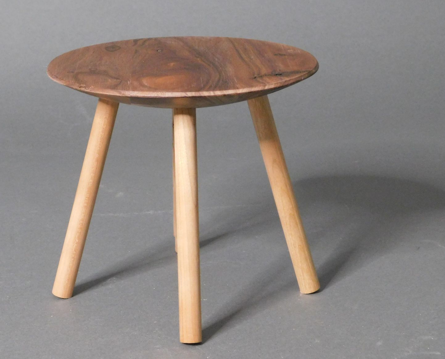

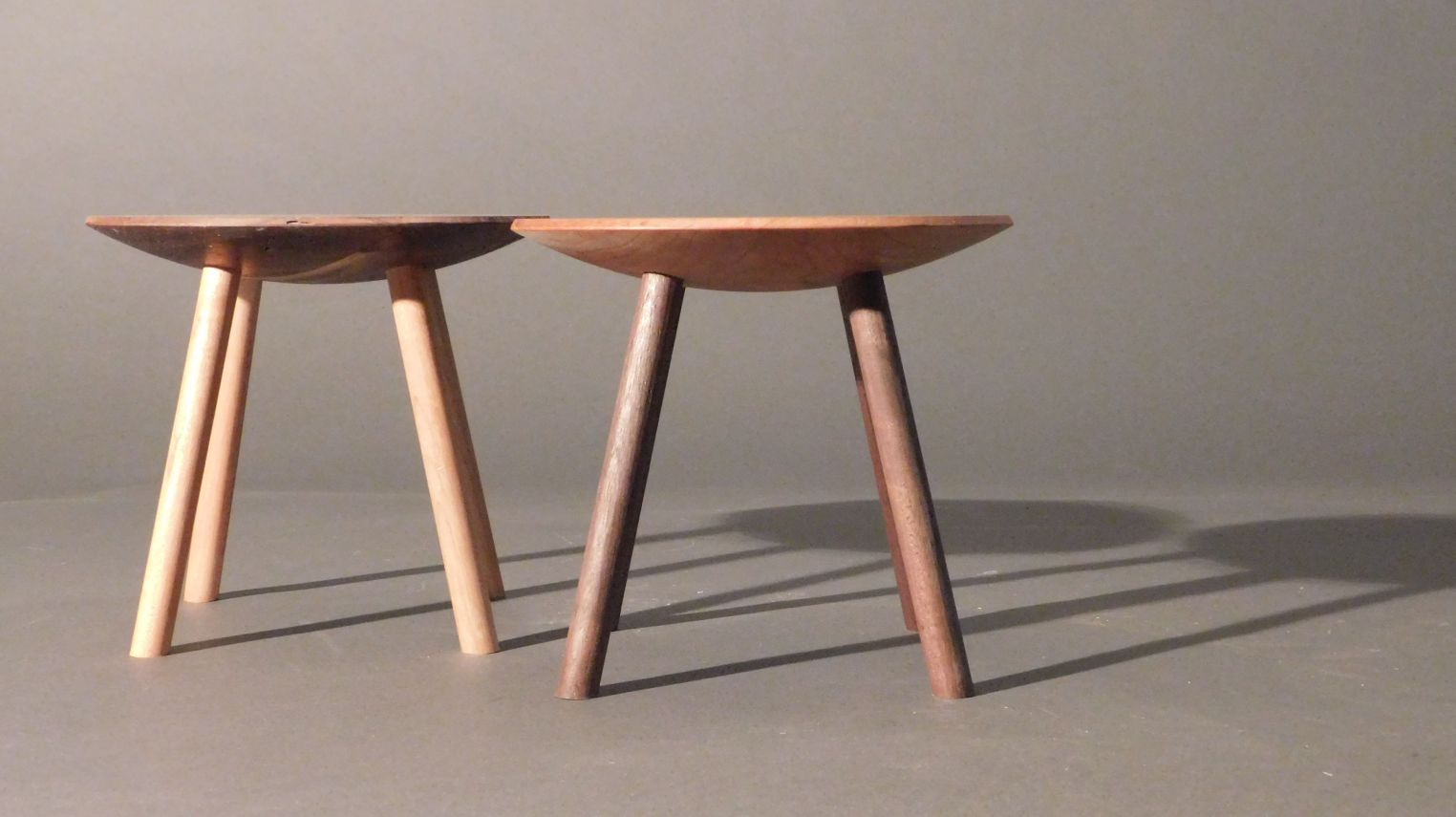

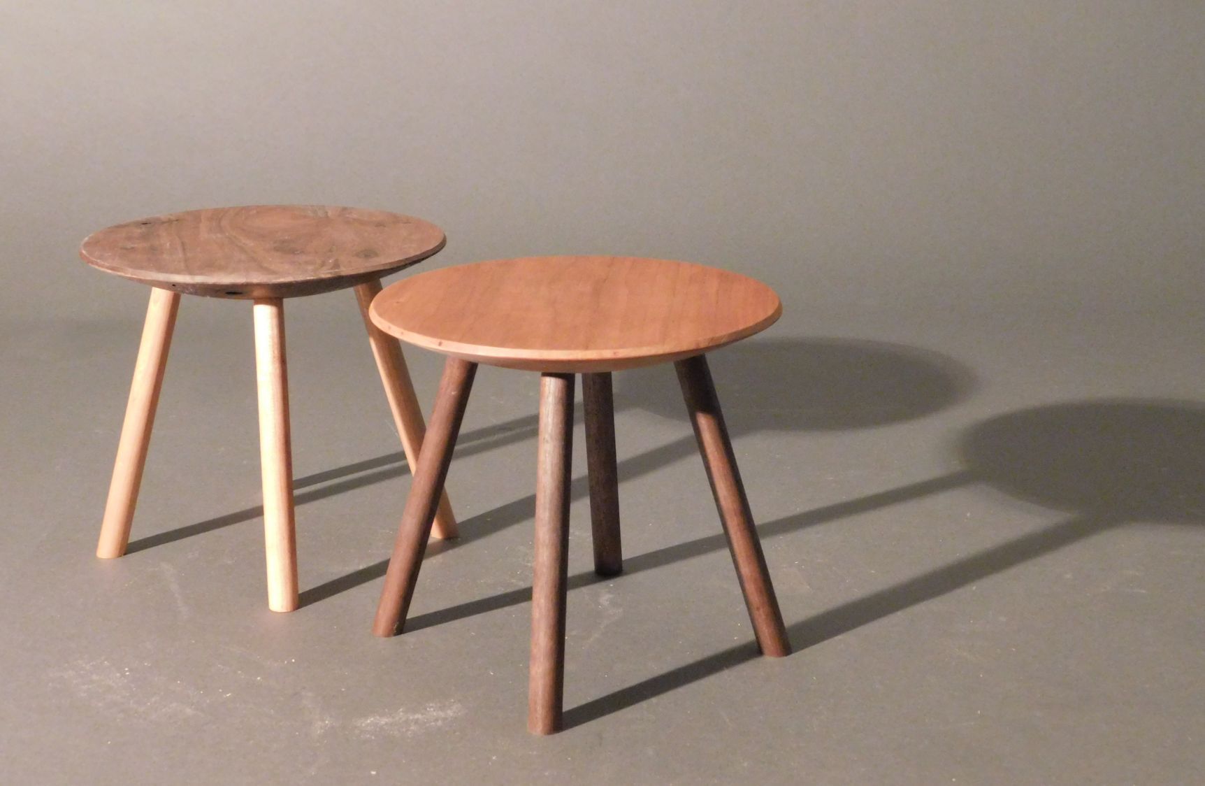

June 14, 20251 yr Author comment_357610 No more cherry dowel, but I had a 36" long section of walnut dowel to use up. Thought I'd use some cherry for top if I could find a block of it large enough. I did find a chunk up cherry, so made a top from it, and used the walnut dowel for the legs. Here they are. Ying and Yang. A lower point of view with them rotated 45 degrees. Without the bright light the walnut legs are much darker. Both now have at least one coat of tung oil on them. Top surfaces have 3 coats. Cherry top turned out nicer than I expected after the tung oil was applied. Now I either need to but some potted plants or find a relative would would like there. Thinking about scaling up the design to make a stool to plant myself down on. 5/8"d legs become 1.25" legs. 8" top becomes a 16"d seat. I could just scale up the vectors used to make the larger one. 4D Report

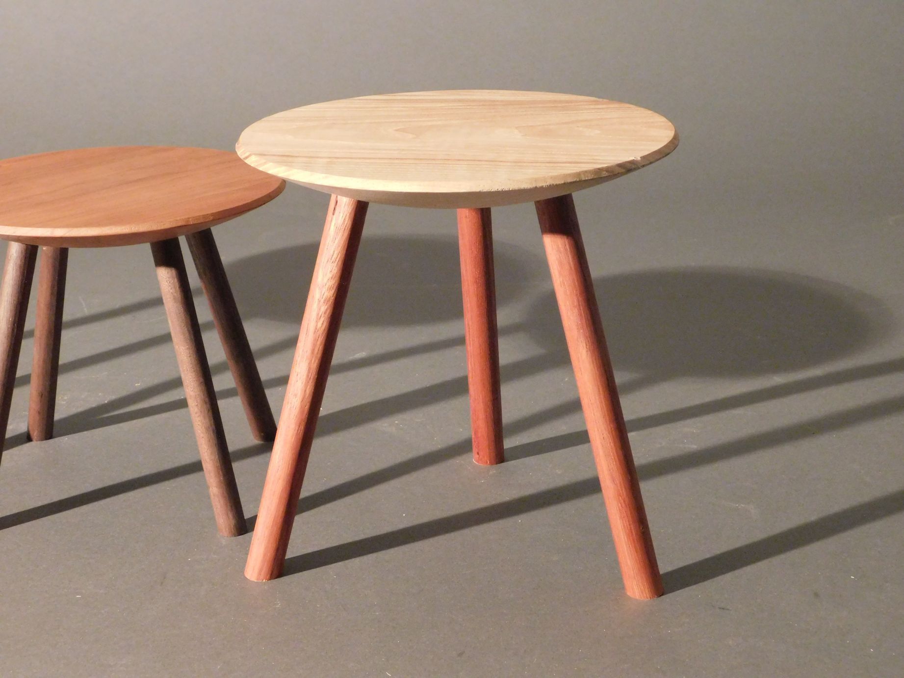

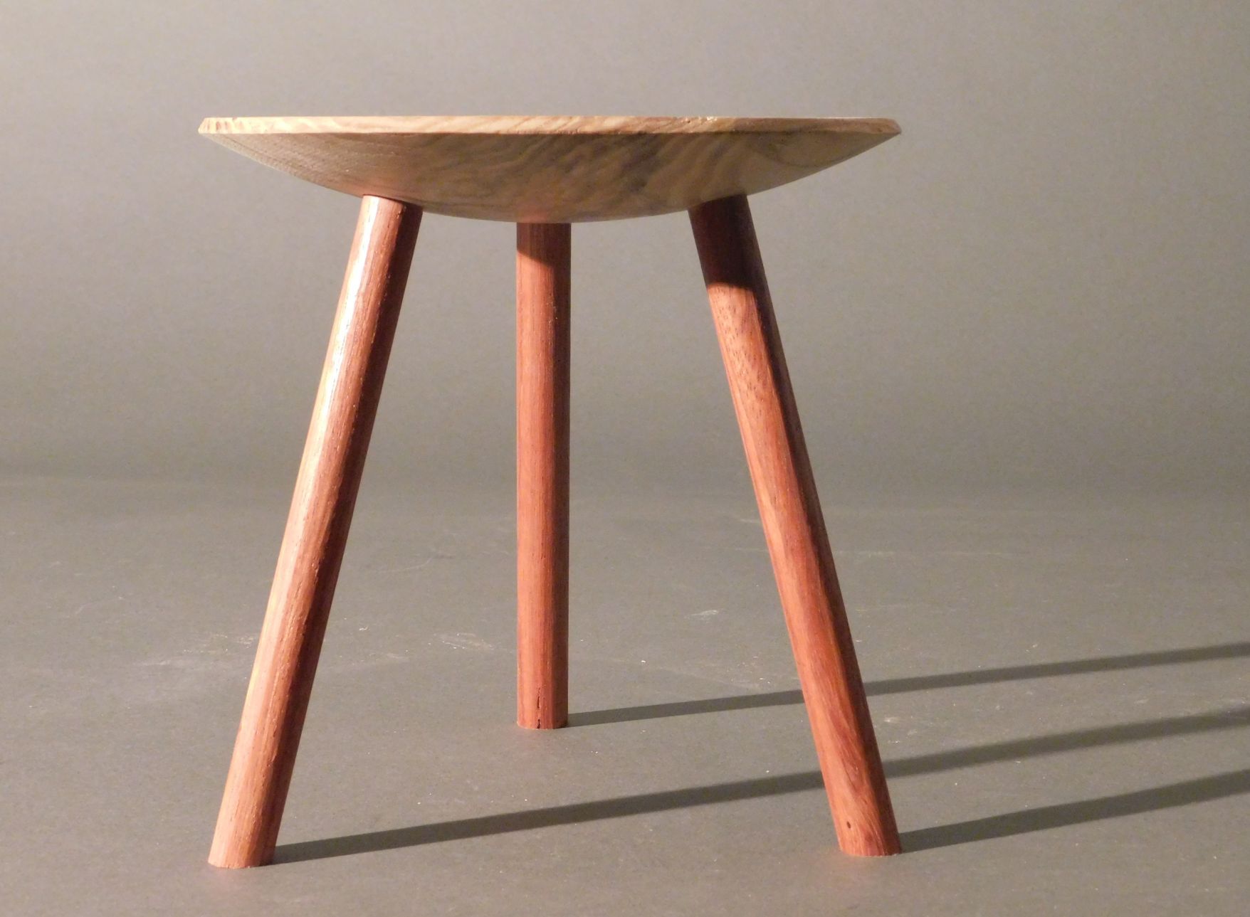

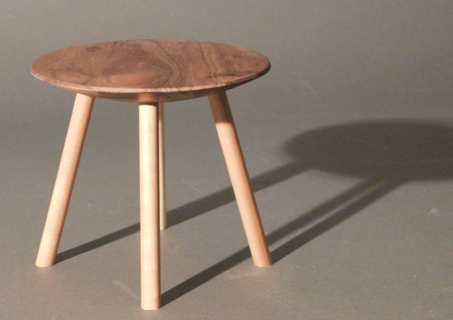

June 17, 20251 yr Author comment_357714 Found a thick scrap of White Ash lurking under a stack of other cutoffs. Only thing I could think of to use it for after staring at it the last 20 years or so would be a plant stand top. For legs I had some red zebra wood scraps, 3/4" thick, so I sliced them and rounded them off at my router table. Only enough for 3 legs on this one. The edge chipped out a little, but not worth worrying about. This Ash and red zebra stand is a bit larger/taller than the previous two. The 30 degree chamfer on the edge point to the center point of the dome top arc as do the legs. Perhaps this continuity will help draw focus on whatever plant sits atop. Three legs that are 3/4" diameter actually have more cross sectional area than four legs 5/8" diameter. I suspect that'll be strong about for house plants that are small enough to sit on this stand. 4D Edited June 17, 20251 yr by 4DThinker Report
