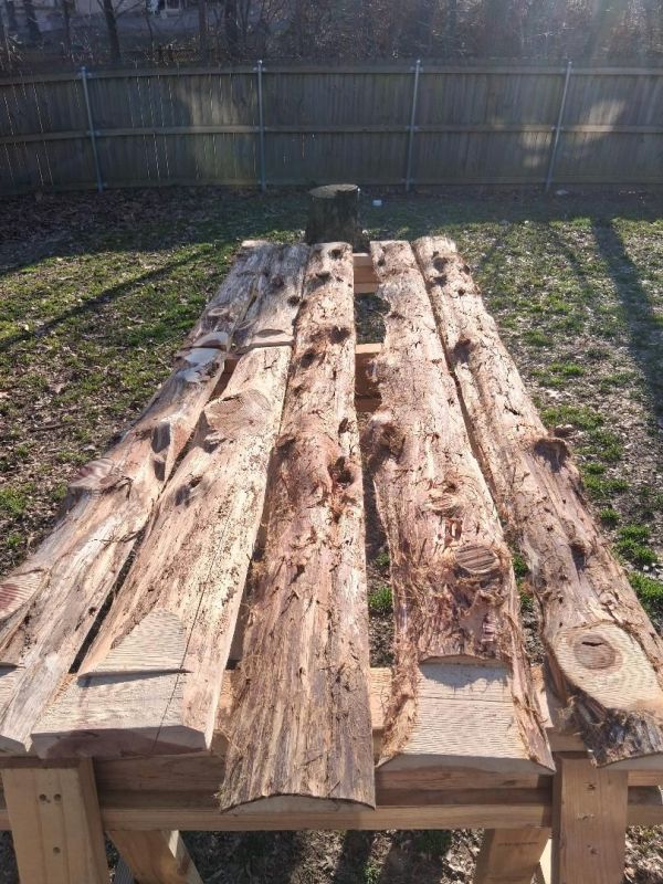

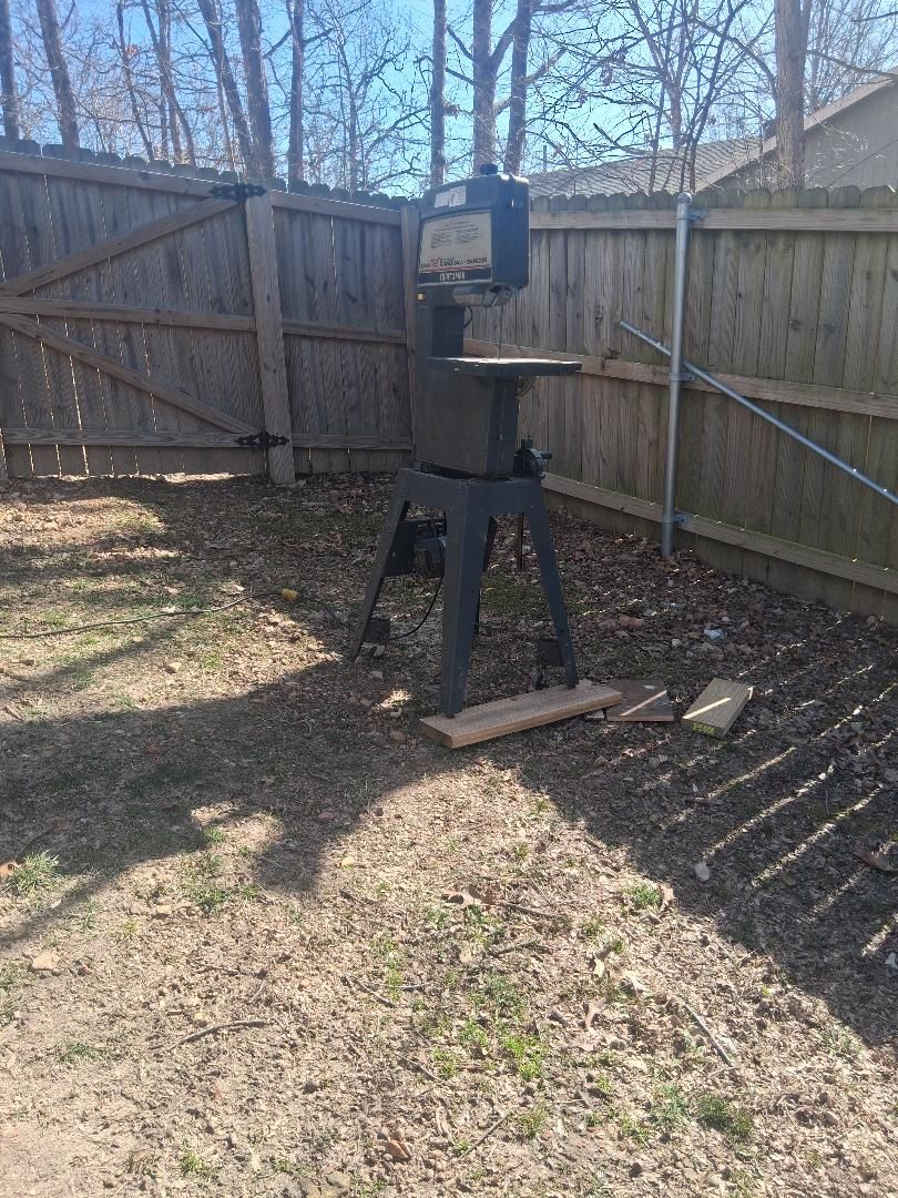

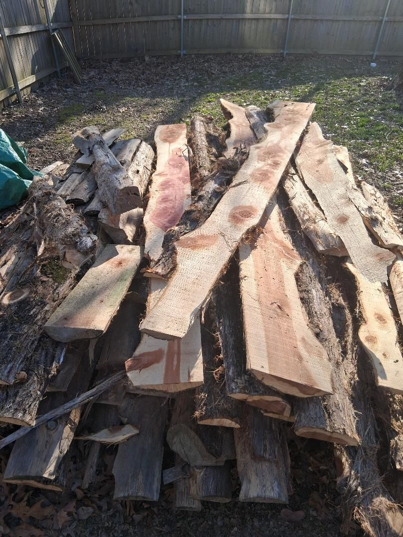

March 13, 20251 yr comment_353582 Brought in approx 3000 lbs first cut Eastern Redcedar (Juniperus virginiana) for raised bed projects (see pics). Due to length of raw material I moved band saw and table saw outside. Project consists of 1 4x8ft x approx 12 inch height, 4 2x6ft by 12" beds, 1 4x5 ft and 1 4x4ft bed to start with. (see attached pics. So far I have all wood cut for the 4 x8, the 4x5 and 1 2x6 bed. As you can see from pic the challenge is to notch each end for corner supports since I am putting bark side on inside, some are 8-10" wide and band saw has a 6" clearance. Since I am going with a live edge on the top board I have to cut bottom board flat on both sides for a good match with the live edge top board. I will add more pics as I get the beds assembled. Question: I have this thought that if I build a surfacing sled for my router I can take enough wood off the bark side of a couple of the wide slabs so I can use them for special projects. Thinking I would need a surface bit, (router is old B&D and 1/4" shaft. I don't buy a lot of router bits, is there a better brand I should look for? Report
