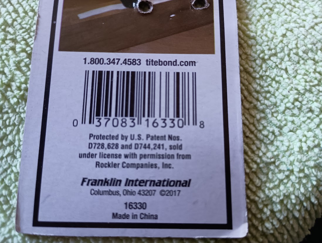

Titebond provided some merch for attendees.  One thing was their glue spreader that looked a lot like Rockler's except for the color.  I got mine into the glue box today and  noticed this:
