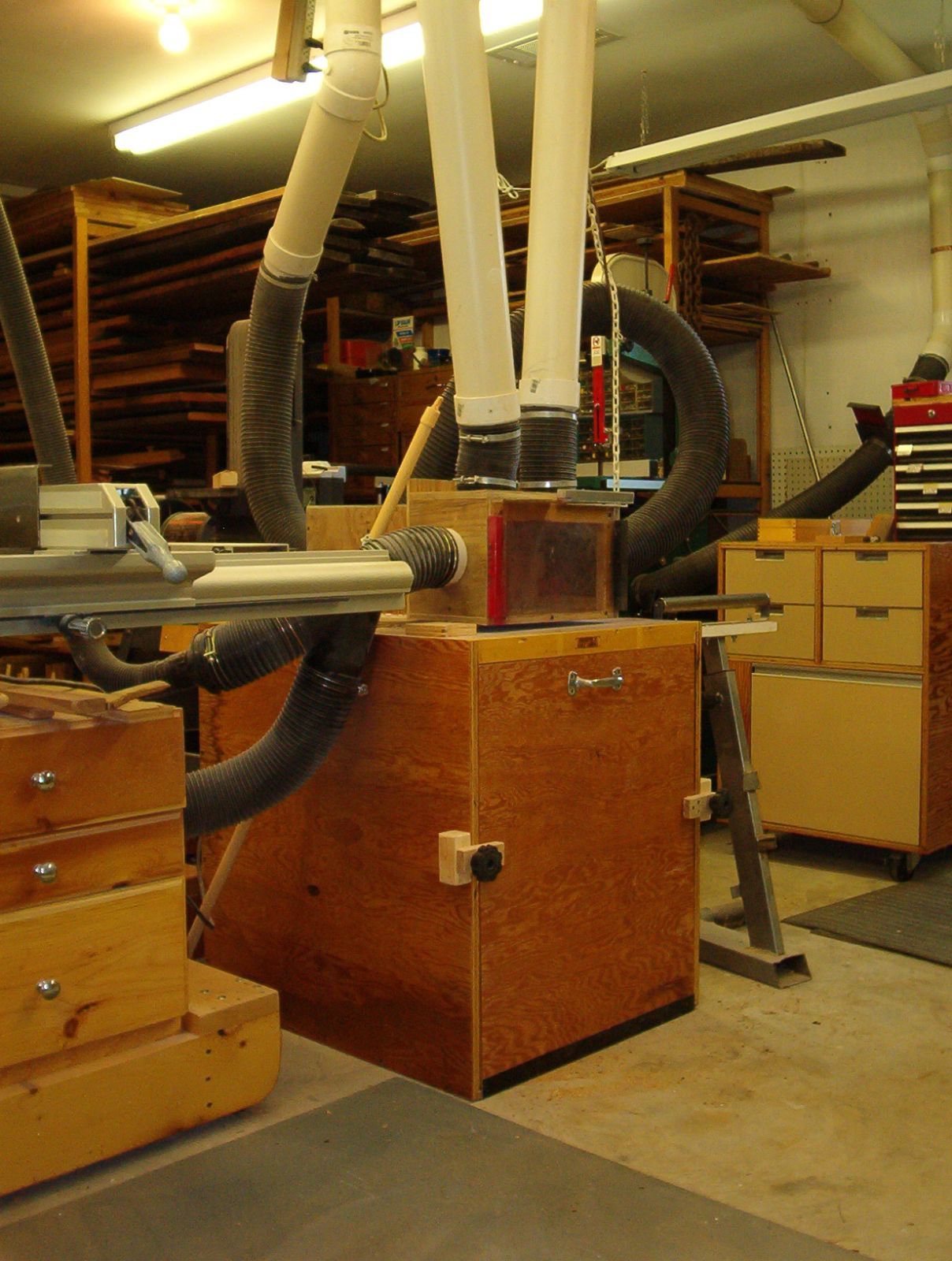

I made one from ply years ago , a Shop Notes plan. It is still in line for large chips . I added a Dust Deputy with 6 inch hose connection a couple years ago and love it but I do wish The DCchipcollection(2).jpg.9f79d9e6ccdeebace9828085737053b2.jpg
dustdeputy.JPG.b36fa606e6178a6d63120092d7e01c1b.JPGwas 55 instead of 30.

For me the larger chips (especially from the lathe) drop in the home made box. Almost all the fine dust is in the Dust Deputy.
