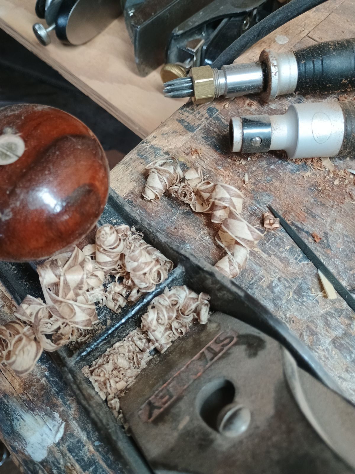

Even though I was expecting it, I was really struck by how cool the shavings are:
