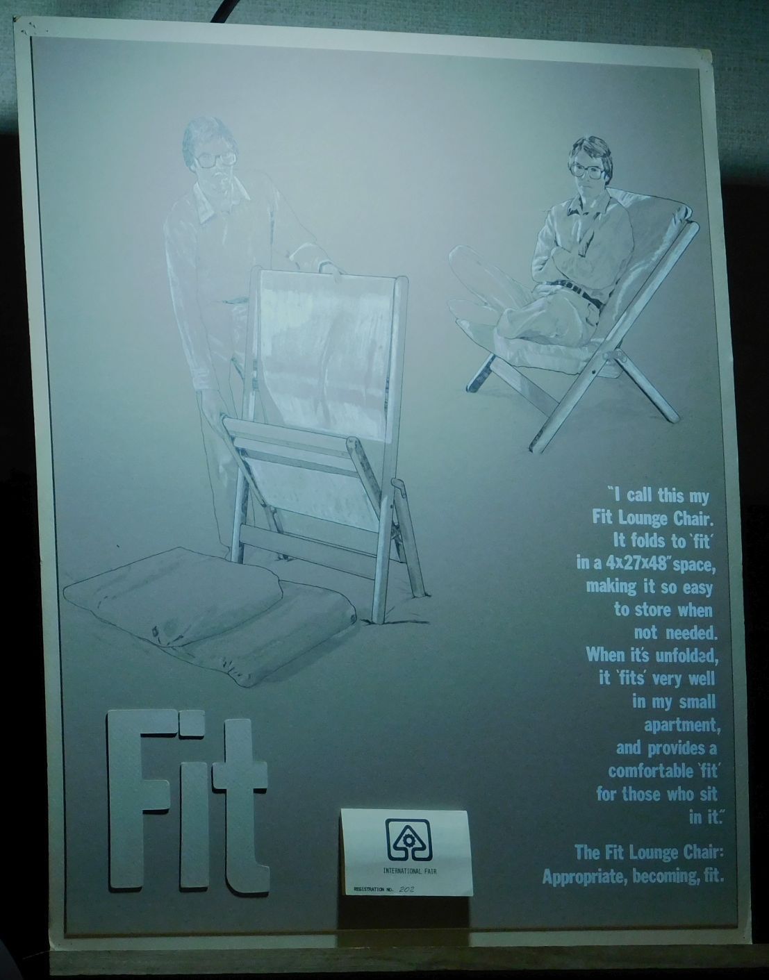

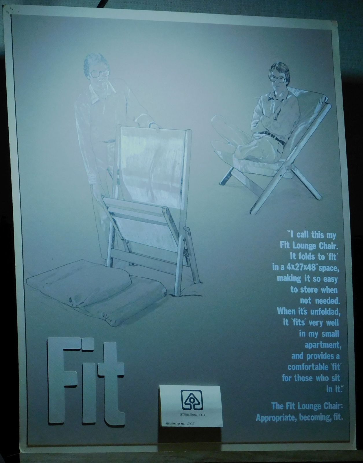

Definitely an effect, but not enough to be worth it in this version of a filter.  Camera is still a bit too sensitive compared to my eyes but flipping back and forth between photo with the filter and without the filter the top area is dimmer relative to the bottom.  Still a washed out area in the center.  Top image is without the filter.  Bottom image is with the filter on the light. nofilter.jpg.eac15369595f023ed49a0ea9b2808c80.jpg
I need to find a way to reduce the light hitting the center washed out area.  Rethink the 3D shape of the filter. Start with a thicker piece of HDPE.
