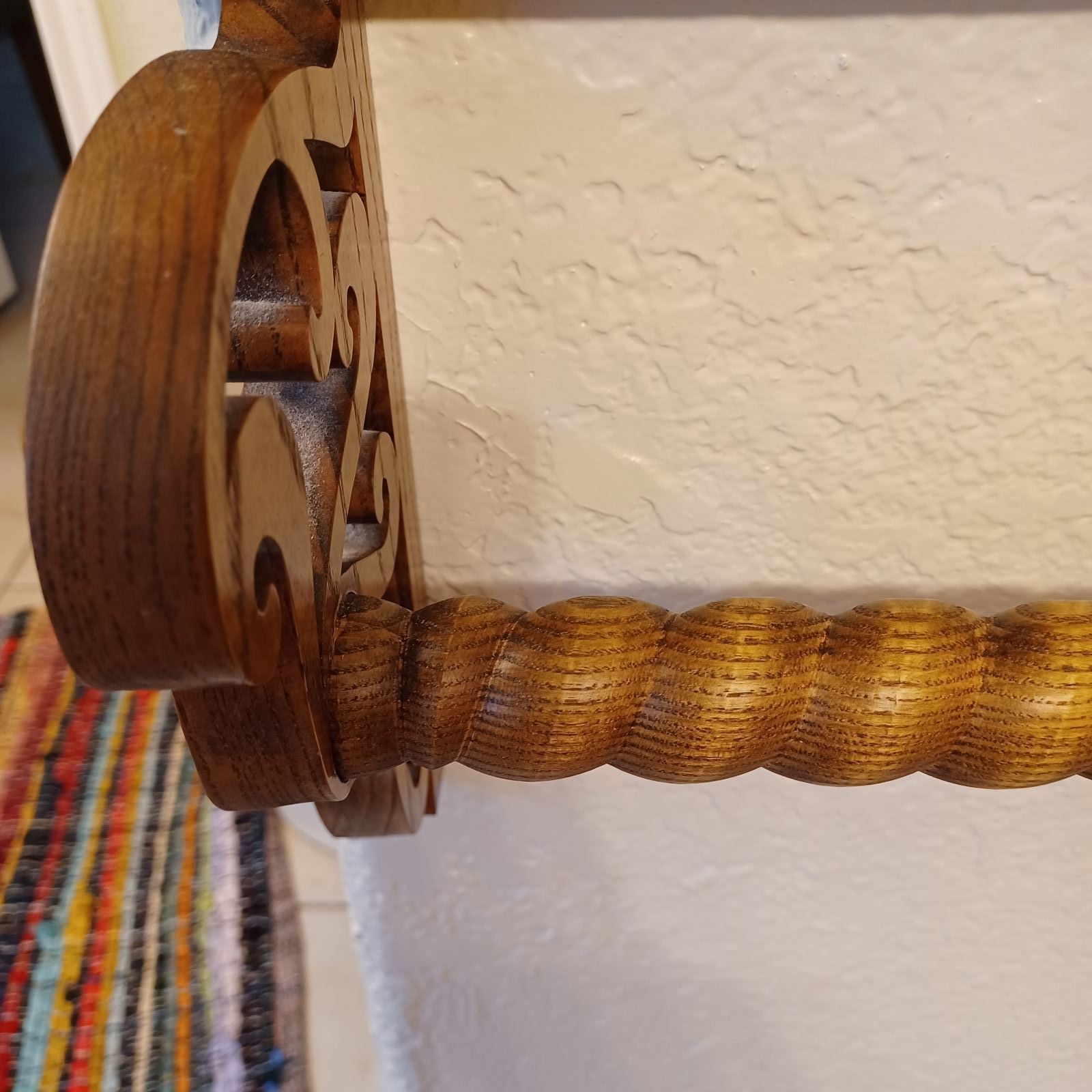

February 8, 20251 yr comment_351444 The easiest with best results and will make the wood look better after applying only one product and a little thinner is 100%tung oil and not tung oil finish. This is completely two different products and the bottle or can should say 100%. Thin the tung oil with about 25 % paint thinner.... Put the coats on with rag or paint brush then in 5 minutes or so use a dry rag and remove everything that will come off.. Let sit for a week or so, longer if it's not summer then do the same thing 2 more times with the extra time in between applications. This is a towel rack for the bathroom. I stained the end pieces and the rod with the same thing..I then sprayed clear lacquer on the end pieces and since there would be wet towels hanging there every night I always use 100% tung oil where water might affect a finish.... Enlarge the picture and you will see enough difference to be confident 100% tung oil will be the best finish you can apply on wood. It brings the beauty out of the wood better than any thing I have ever used. Especially when one will put the things out side. Also compared to putting on any finish one will end up using less tung oil than anything else. It does have a shelf life. So I would suggest buying one quart size jug then give us your opinion of the outcome in a few months. I know it is almost water proof for the first time I ever use it I applied three coats in about six weeks time and I used the same bathroom wash rag.. I laid it out flat each time to dry until the next appliction but the second time I folded it into a cup shape so after it dried in about 3 or 4 weeks I poured water in it and sit it up so I could tell when all the water disappeared. This little experiment with the water convinced me that the guy that had told me how good it was became a very good friend. I want my friends to be honest and not give advise when they don't know squat. Report
February 8, 20251 yr comment_351445 100 tung oil needs no top coat. This quilt rack was built and installed about 15 or so years ago when I remodeled the bathroom. And with all the wet towels that have hung there wet I would say , yes my friend tung oil will keep the wood looking brand new.....for a long time. Report
February 8, 20251 yr Popular Post comment_351465 Also I only use 100% tung oil directly on to wood. If I have to put coloring on the bare wood and lots of it stays on the surface then I go another route and forget the tung oil.. Last post I said quilt rack and should have said towel rack.. Been working on another quilt rack and it is stuck in my little brain until it goes out the door. Report
